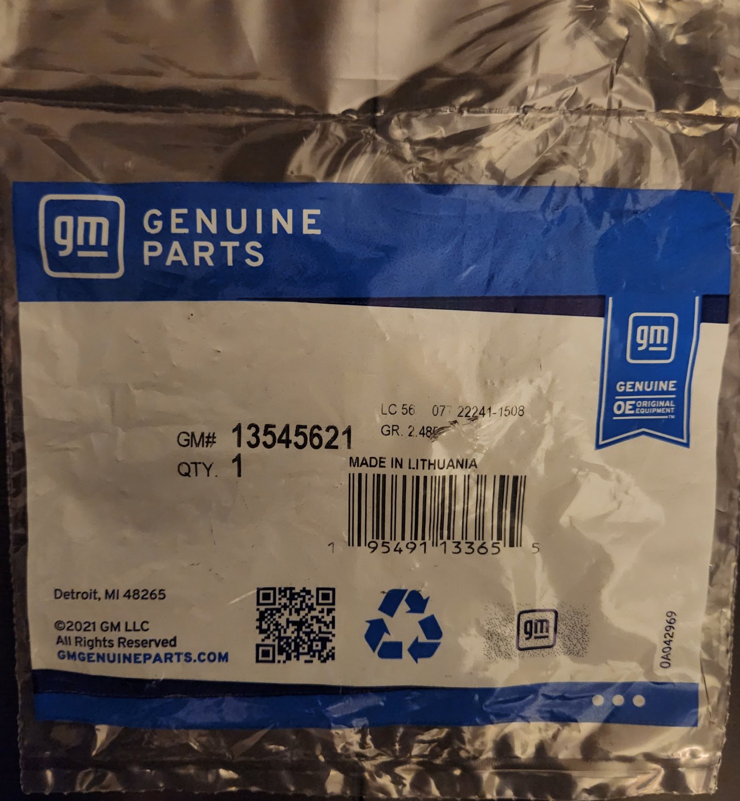

When searching I stumbled upon a lot of info in a corvette forum. Seems the C8 vets have P/N 13529378, older sensors with that p/n are good, newer ones aren't. Those guys are pulling serial numbers together to try to figure out a cutoff (props to them for the effort as some of them reference coming here when researching too). When going to dealers, before the shortage, the P/N 13545621 was being used to replace there's. Seems to me the two are likely backwards compatible so I'm going to try the older one from an ebay seller that seems to have old stock (at least the vet guys have had success with that seller but who knows what you'll get). Should have it in 4-5 days, I'll report back if it works as they seem to be more readily available, even though we could still get a bad one if not old enough inventory...

One of the local dealers I talked to didn't have it but rattled off a couple dealers that did. None were within driving distance but I contacted the closet one. They weren't willing to ship it. I could keep going down that route but then I'm thinking the older P/N (older stock) may be the closest "known good" sensors so far, so giving that a shot.
