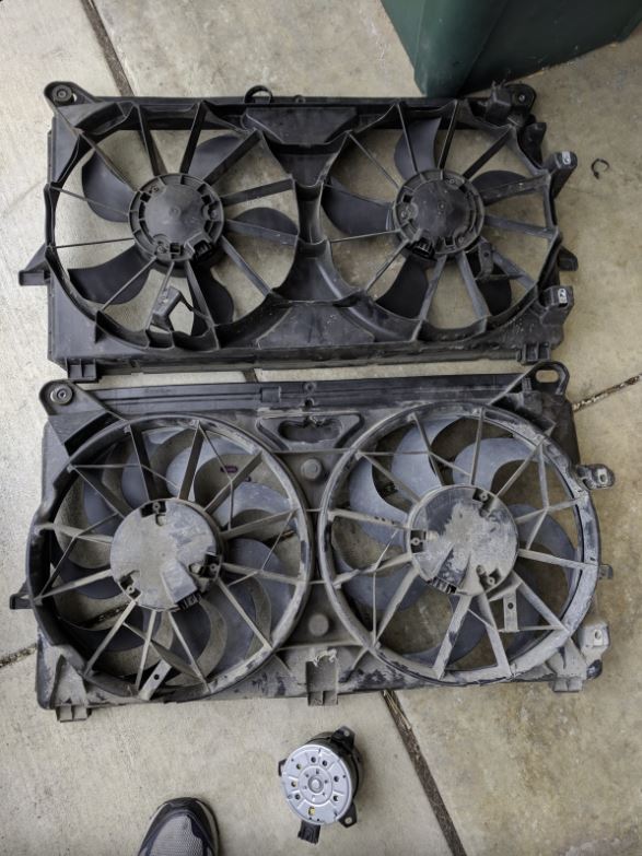

I just received my new fan assembly: TYC 622210 from amazon.. Supposed to be the 7/9 blade set up.. As mine were replaced by PO
with a 7/7 blade aftermarket fan. I DO have the HD cooling/towing. So I really wanted to make sure I had the 7/9 Blade Assembly.
Well, the fan that showed up in the TYC box is a 7/7 set up.. So same as I already have.
Has anyone found a replacement true 7/9 set up ???? I'd really like to have max cooling as supposed to, esp with my mods and towing
