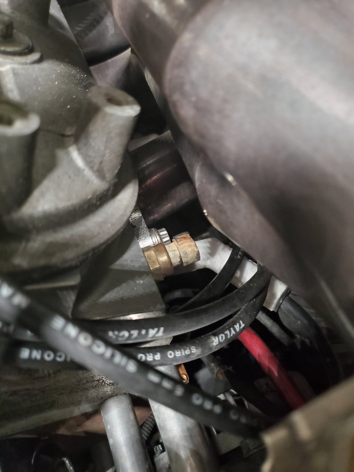

Turbo drain fitting was leaking, fitting was nice but the oring shriveled up and hardened.
I couldn't find another original so I just threw a paper gasket between it also, seemed to hold.
