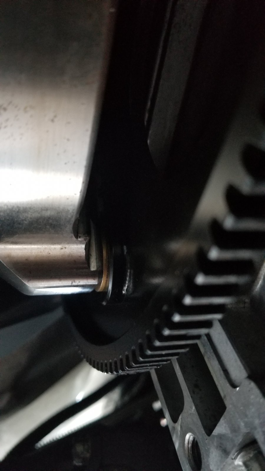

That crank will need some attention, looks like the metal moved and did not come off so it should still weigh the same. But, there's probably more than meets my eyes lookin' at pics over the internet!

ripped a little more apart, cleaned up gasket surfaces, i drilled and tapped the lifter towers under the vlom cover to completely plug - except i used some tap i had for some reason and cant find imaginary set screws for it :lol: m8x.75, will probably redrill to a common set screw size. pulled the rod, filed the edges made from it off the crank (was hardly anything). she getting slapped back together boys sorta half assed, i'm going to check some weights and tolerances so not completely blind
