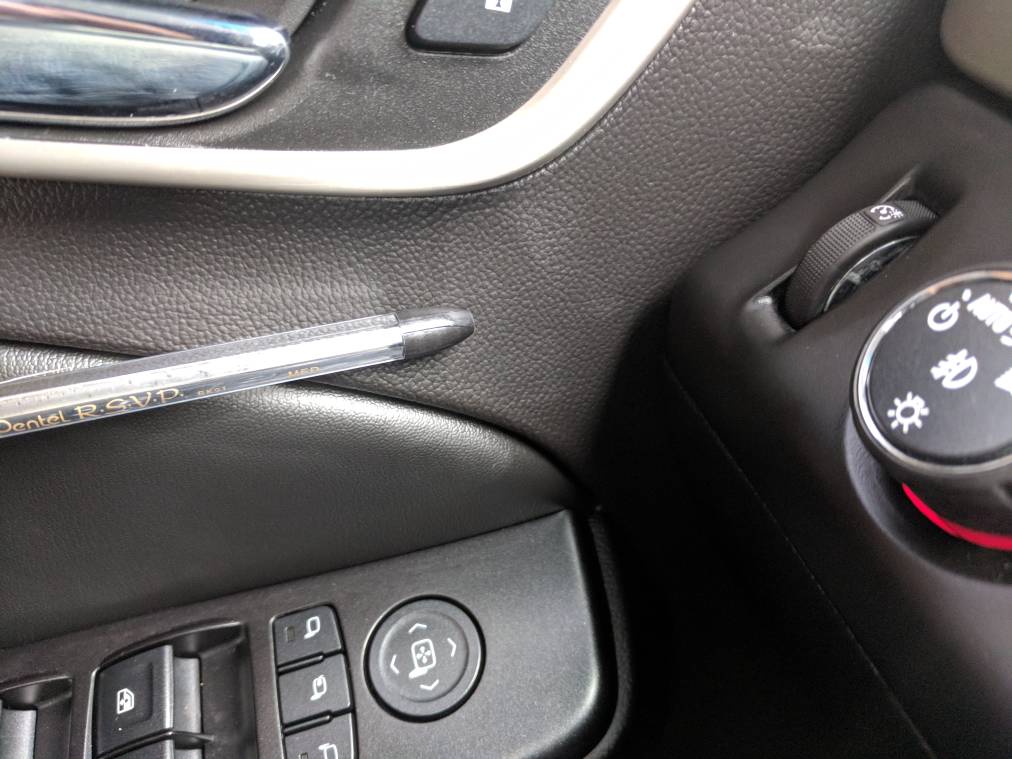

Vibration in my Denali same place. Music, even when not very loud, and other conditions, cause it. If u put solid pressure on the door panel under the door handle/lock area, as close to the dash as you can, it stops (on mine). Pulling my door panels off for a diff project when the weather breaks so I plan to address it then.
Hope this helps.

Here is the pressure point. Figure I'd take advantage of my time sitting in this Chick Fila line. a329a54cc99953c26704d1dc2bc39ef8.jpg
