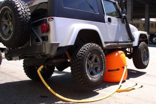

While looking at jacks/jack stands earlier I found this thing. Never seen this before but I'm definitely getting one of these, esp if there's one MADE IN USA. Uses exhaust to inflate. Lifts up to 8800lb 31.5" genius
