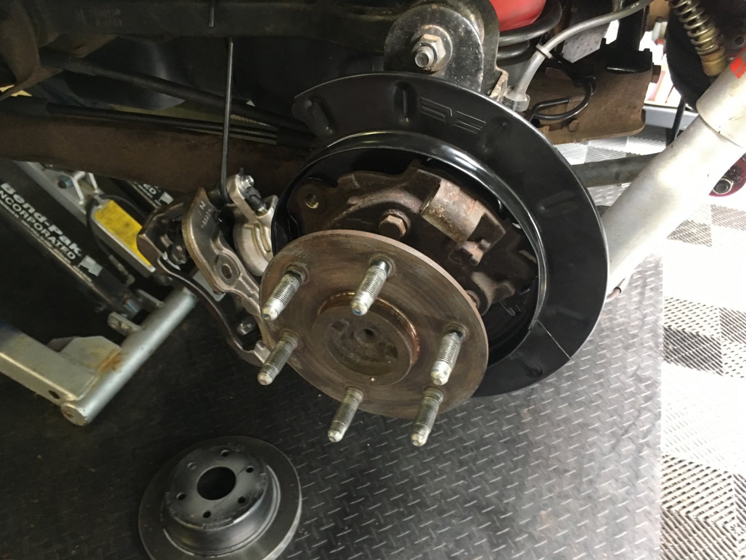

It's a pretty easy fix with the 2 piece ones. Just use tin snips to cut the old ones off, and the new ones go on pretty easy. It's a couple hour job. Whoever came up with the 2 piece idea was a genius. Having to pull the axles would be crazy. But then I had to do this to my daughters VW just to swap headlights today. View attachment 64260

Not really hard at all. Took about 3 hours, but I also replaced the r/rear E brake cable and painted the calipers.
