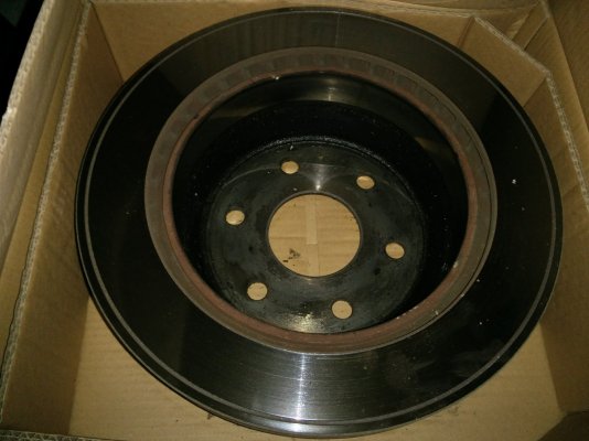

This is a very intermittent noise that you cannot hear at speed. Brake function is normal and so is the park brake function. The noise is not so much a squeak but more like a "sqauwk" noise. I have no idea if I spelled that right. I do know that I must have accidently left the park brake partially on and it ground up some of the park brake shoe surface and I would bet over heated the drum hat inside the rotor. I find it hard to believe that I did leave the park brake on because even when I don't set it I have the habit of releasing that lever every time before I put in gear. I think that one or both of the rear brake cables did not release properly and started the ball rolling on this problem. What ever caused it, I am going to fix this problem/noise because I cannot stand to hear that noise when moving at a snail's crawl pace. For a rig that performs flawlessly in all other aspects, this must be gone.

If you read my Build Thread, you will see I leave no "stone" unturned when it comes to taking care of this rig. I have replaced sooo many parts before their time was up, just because I could and knew they would be needed some day. One of these days, my heads are coming off because during all this work in my thread, I had some exhaust manifold bolts break during removal for motor mount access. I opted to use the Dorman kits for re-clamping the manifolds and my rig now has 3 band-aids on it. That drives me crazy. Thought about it the whole time when on my recent 5500k miles trip but had no problems.
