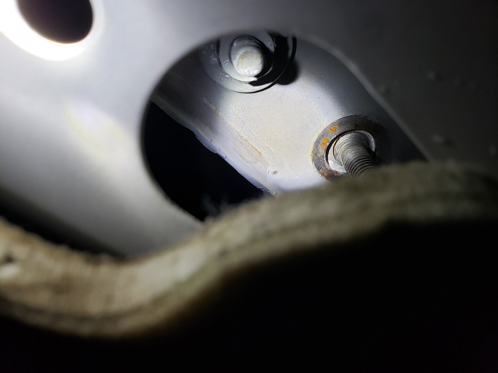

The end caps on your luggage are pretty easy to remove. I use a really small flat blade screw driver and gently work my way from the end of the cap in towards the chrome piece and gently pull it up. There’s just plastic clips on the underside. Once they’re released the whole cap comes up and off. That way you can check the bolts to see if there right underneath. I wouldn’t think that would be a source of a leak but you can always check it. I’ve had the same style roof rack like what your truck has on my 2006 xl, essentially the “esky style roof rack”, for about three years now and have never had a leak from there.
