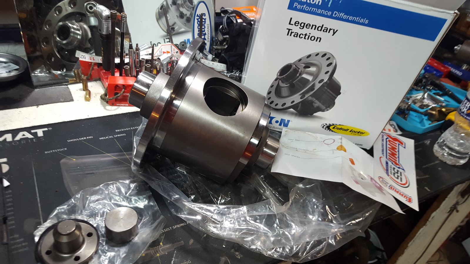

Highly productive day...
Thanks to last weeks "coaching up" on the fundamentals of axle i.d. by VIN from @swathdiver & @Geotrash, I was able to end my recent string of strikeouts yesterday...
Made a 3hr road trip down to Lewisville Motors in Winston-Salem, NC and scored this beauty
Undoubtedly the 2nd best rear end I've ever brought home ;)
.....and thanks to some early advice from @Doubeleive this was sitting in front of my garage when I got back
1st thought: wow this box is way heavier than I thought it was gonna be
1st thought after opening box: :drool:
Case thickness of OE 9.5" G80 Carrier= .395"
Case thickness of 9.5" Truetrac= .795"
27,590
41,914
that should hold up to a beating
