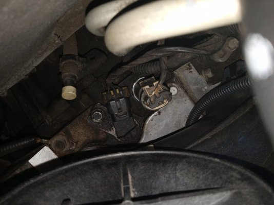

Wouldn’t it have pressure without dod anyway since oil pressure sensor is there? Mine is without dod but was pissing oil everywhere around the cover
The OP sensor is behind the valley cover screwed into the block casting. These valley covers are all known to have the bolts vibrate loose and then harmonic vibration and accumulating dirt and leaking oil act like sandpaper on the gaskets IMO. Add to that high mileage and accumulating blowby increasing the crankcase pressure.,,, DAMN I need to get to bed.

It's little grungy back there but I don't see it pissing out. Still, I'm going to replace it when I replace the knock sensors (again and with quality parts).
Yeah that's the early stage there. Good pic.
