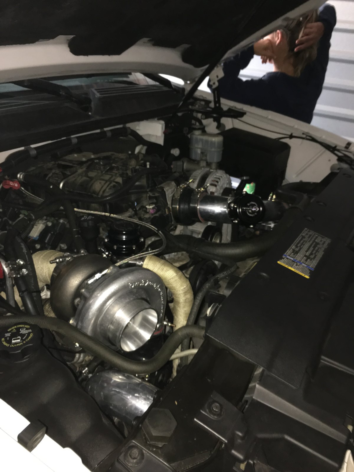

Wanted to add that you could also look at relocating the battery over to the secondary battery location behind the driver's side headlight. That and removing the the stock airbox should give you enough room for a turbo up under the hood. Accessing the spark plugs would probably lead to the coining of new curse words though.
The intercooler, could still be a pain, but is do-able.
