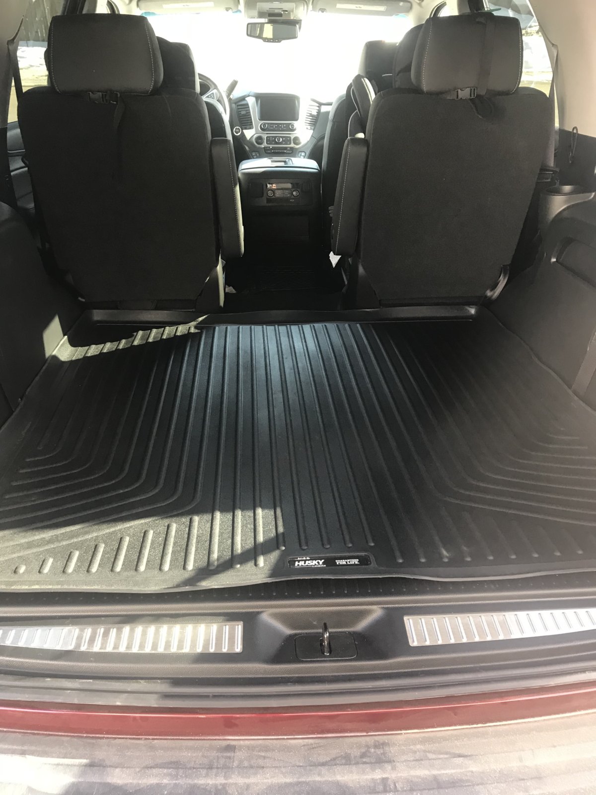

Problem solved. Put seat back in to see if that was the issue. While pugging it in I could hear something hitting floor. Looked under carpet and found a wire unplugged. Looks like it goes to an antenna for the keyless stuff. Looks like a little square box. Plugged it back in and all is good. Took seat back out. I must have unplugged it while pulling on the seat plug in. It’s tied in to the same harness.
View attachment 196792 View attachment 196793 View attachment 196794
You almost have a LWB now
