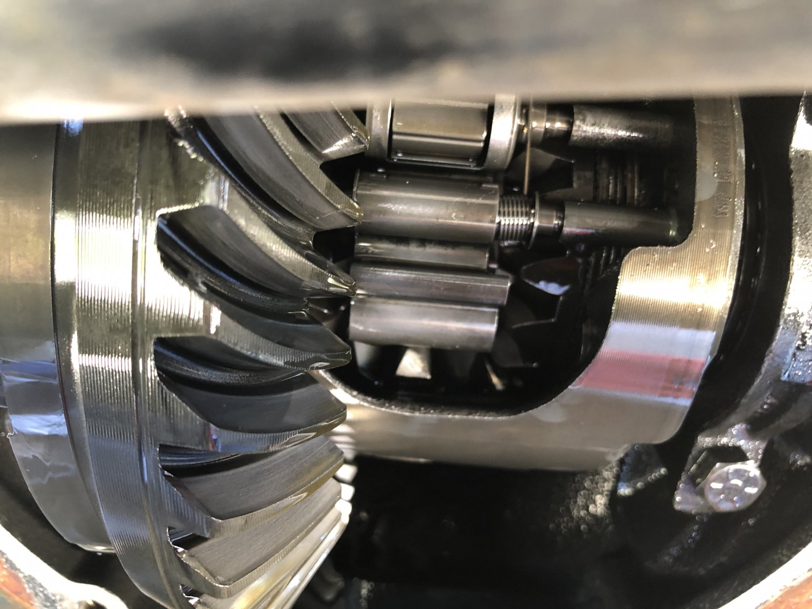

Just about every 1500 nbs is 140. Think the only one that's not is the 1500 HD.
OP I still think you have a problem in your diff. Sway bar mounts don't make noise when you pull and push on the tire in and out. Pull the cover off and have a look. Also have someone pull and push while you see what it is. You don't want to loose an axle going down the road trust me it's not a fun time.

I asked the mechanic if he thought it could be the diff before he inspected it. I can only assume he knows what he’s doing. Hopefully the stabilizer bushings and links I’m going to replace will cure the noise I hear when driving, and this amount of play is normal. Fingers crossed

Well you said that the noise you hear in the video is the same noise you hear while driving. I would think that you have Isolated it just need to figure out why it's making the noise
