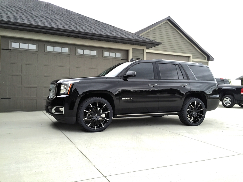

I have the perforated seats, heated and cooled.... and on the Yukon the the leds are the daytime running light. They are also on when the headlights are on just not as bright. They get put on a dimmer

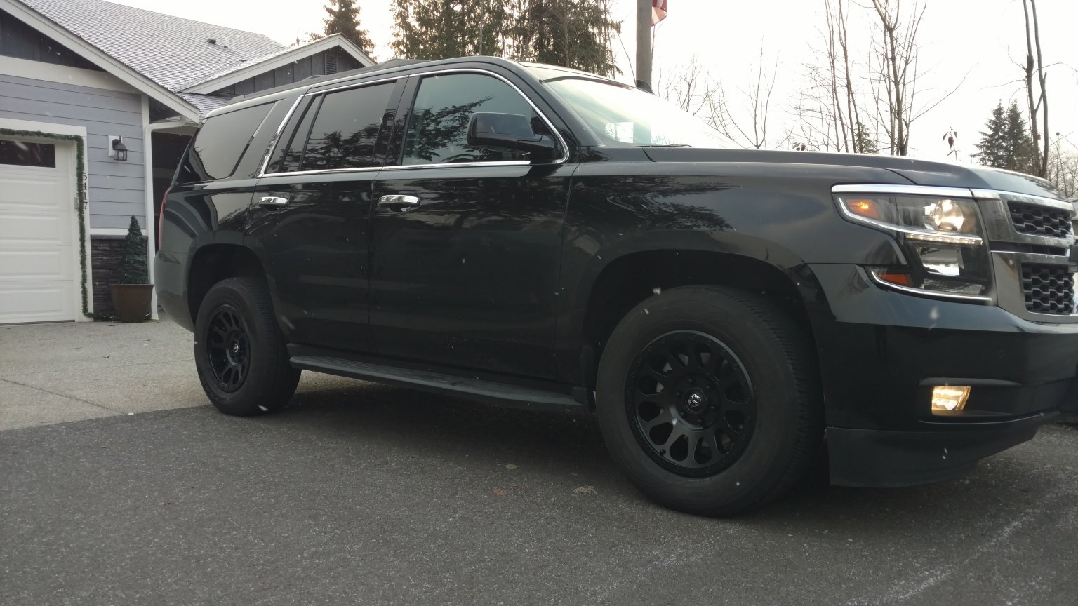

Funny I plan to install the chrome trim on mine...
I think it looks to much like a rental without it.

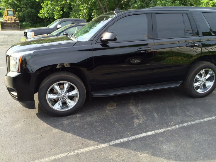

door molding removed
It is glued on, won't leave any holes, park it outside in the hot sun for a bit then take some fishing line and run it in between the body and the molding, should cut the adhesive right in half then pull off the molding

Yours looks really good without the door moulding and the blacked out window trim.
I think it looks unbalanced when it has the chrome window trim and no door moulding like mine.
