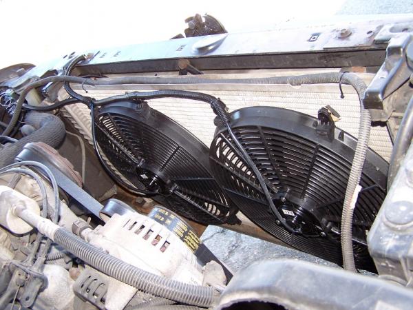

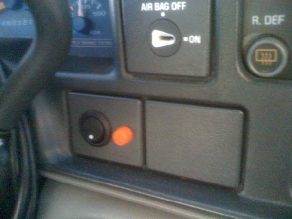

I think that efan installs are fine. You just have to know how the wiring works to ensure no failures. I didn't use a kit, I bought ebay 16" generic fans, and a flex-a-lite adjustable temp controller online, then did my own wiring. I used the fused 30amp AUX connector under the hood to draw power from, then I used a 30amp circuit breaker for safety. It hasn't tripped yet. I including a manual switch in the dash, and an activity indicator light. Installing the wiring took longer then removing the mechanical fan and installing the efans. If you are on the fence about doing this, then all I can say is don't worry about it. Take your time, and it will work. Even the adjustable temp controller arrived pre-tuned with a good temp range.
