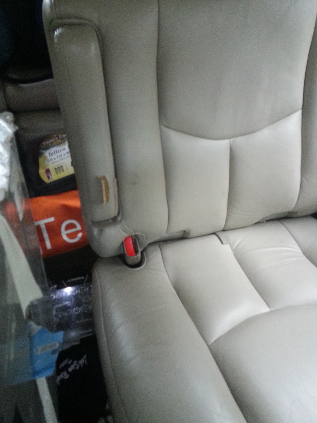

On all of my 1st and 2nd row, but of course mostly the driver's seat, there are some pretty nasty tears and major (but not completely through) cracking. I found Leather Magic which provides a kit that includes patches and color matched mixes, and a pretty solid how-to. Has anyone gone the patching route before, and if so, any suggestions? Anyone used this product?
At this point my goal is more so to protect the foam and close the tears. But if I can remove or really hide the cracks well (which some pictures regarding this product have shown), I'd be all over that.

Not a bad idea, didn't notice you could do just the bottom. I'll look into that. Still a bit pricey, but new is new. I do have a tear on the armrest on one of the 2nd row seats that would still need repair.
Edit:
Driver's seat - probably needs full replacement.
Front passenger seat - tear on the side
Armrest

There are also armrest covers. They just zip on. I know my dad put one on my moms without taking it off. So hopefully it's an easy process.
