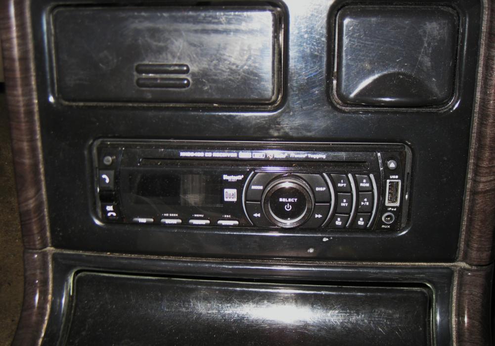

I removed it and added a single DIN Cd player with a USB port on the front. This gives me the capability to listen to MP3 disc and thumb drives loaded with MP3s. I mounted it by cutting off the ears of the factory disc changer and welding them to the radio cage that came with the aftermarket radio.
Thats a good idea. Has anybody mounted some kind of signal processor, i.e an EQ? Or remote bass knob?
