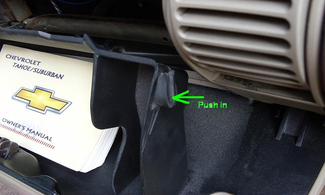

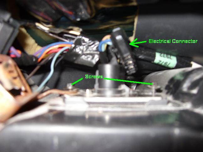

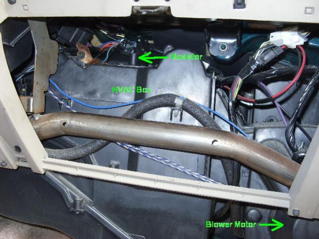

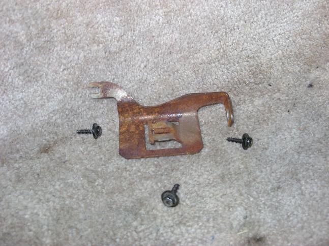

Thank you for the photos Nimrodcs! We went to the dealership and got a schematic that was supposedly for our 1999 Tahoe, but it didn't match at all. Now, we just have to check to see if it's the resistor or switch that have gone bad.
