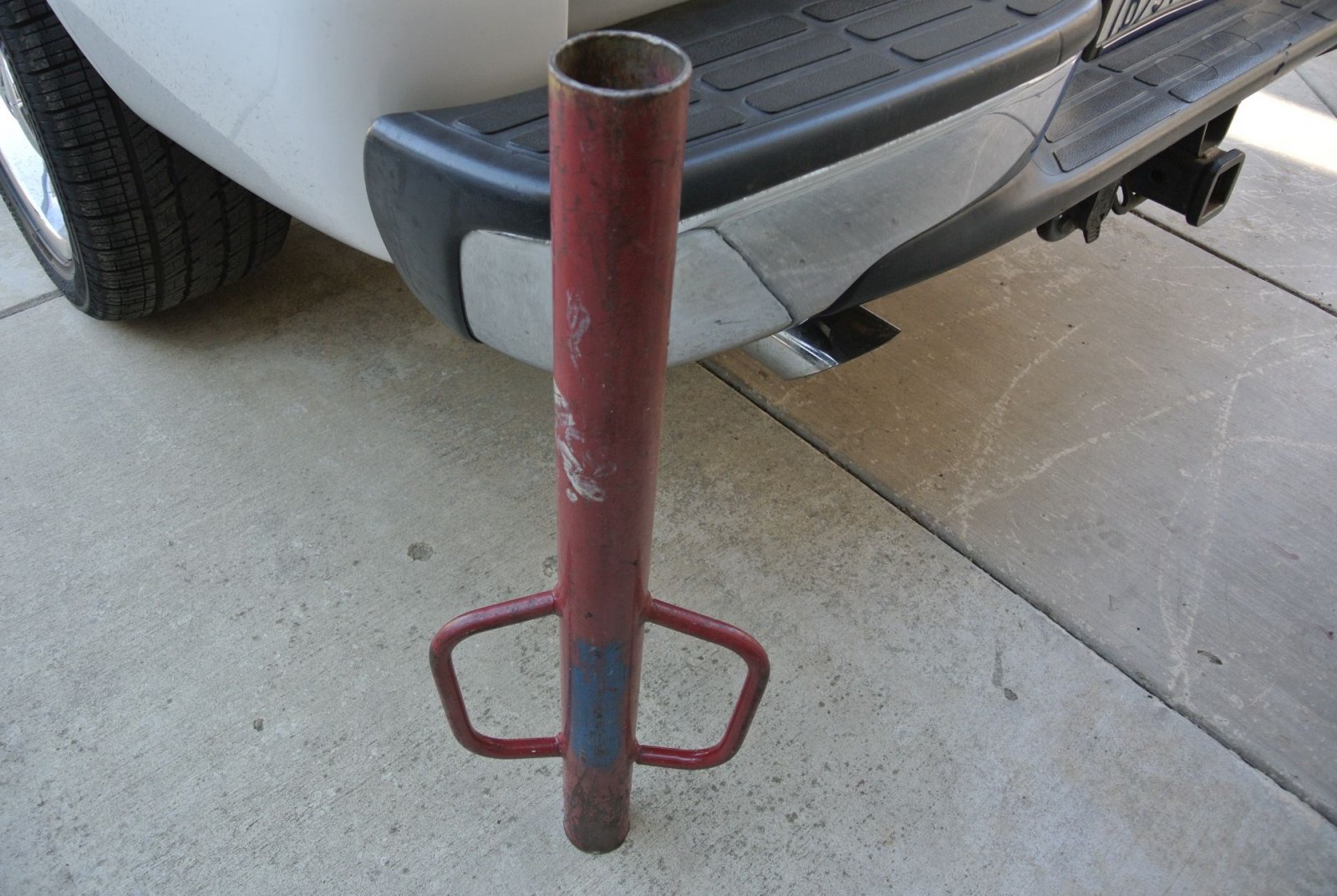

crack that axle nut loose with the wheel on and on the ground. use a breaker bar a BIG one and it should come off like butter
this is what i use where i can

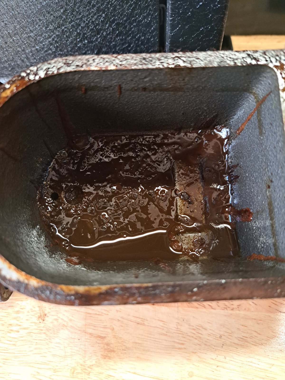

This is a sample of water build up in a master cylinder. I just changed this and the booster on an 85 F150 2wd. His complaint was "my brakes feel funny and the paint on the front of booster is bubbling up below where the master cylinder bolts on".
Duh, ya think!

@Doubeleive I thought about that. Do you just pop off the cap that covers the axle nut? Frankly, I need a bigger breaker bar.
