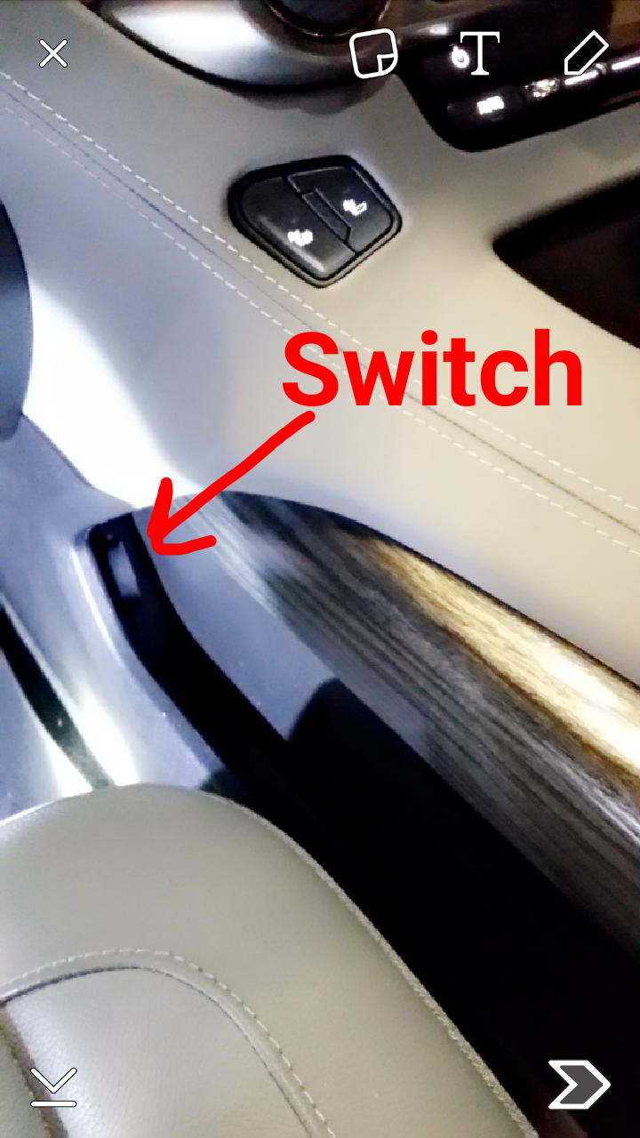

Did you ever get your fog lights wired up. Hoping to put a set on my wifes 15' LT Tahoe. Just wondering about the switch used and hook on the interior.
Thanks in advance
