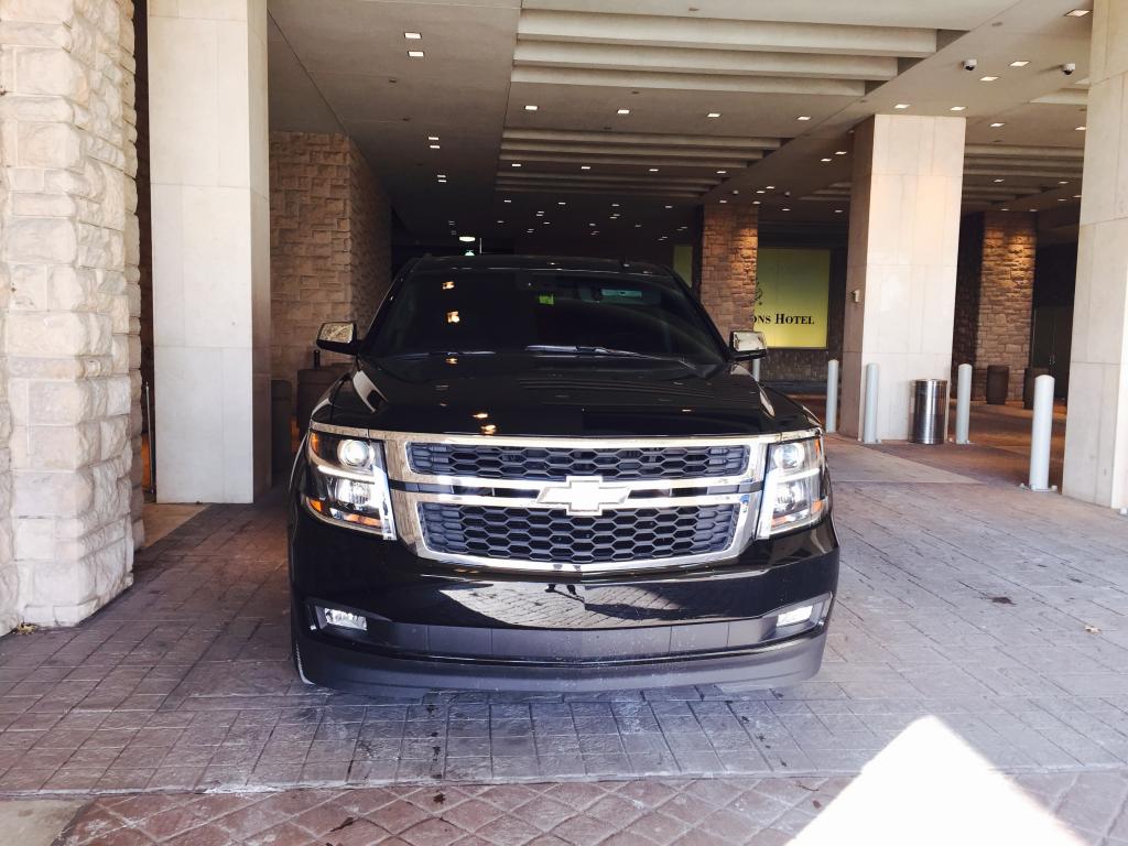

I installed the fogs this evening in about 15 minutes. It's a simple process. First I ordered the brackets from GM Parts Giant for about $42 shipped, using part #s 22936482 and 22936483. I then ordered the lights, that are in fact the 07-13 Silverado fogs, from Amazon for like $36 for the pair! I used part #s 25883245 and 25883246 for this as the pair cost half of what a single light costs using the updated part #s mentioned earlier in the thread.
The install is straight forward. Remove 2 10mm bolts from the bottom of the wheel house liner. They're found just in front of the tire. There's a push rivet there too. Just pop it out. Now you can easily reach behind the filler bracket and remove the 4, 7mm bolts holding it in. Now you're ready to reverse the process with the new bracket and fogs.
The fogs themselves just pop into the brackets with very little effort.
Next up is the harness, which I'm sure is also from the GMT-900 Silverado as well, and the new switch for the Tahoe. Then I'll try and get them wired up. But for now I'm just glad to have those plugs gone. Big thanks to Tom for the part #s.
