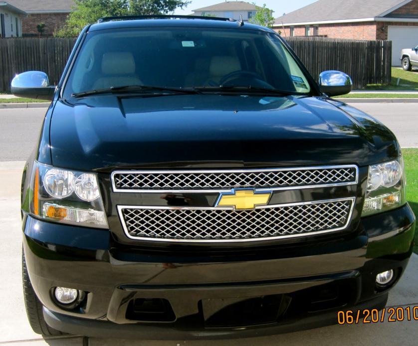

Ok please forgive me because I'm new and do not have a whole lot of experience with cars! But, I've had my '08 Tahoe LTZ since last year, and so far have just blacked it out (5% tint) and kept it detailed on a regular basis- hard to keep the leather clean with a 1 year old and a 2 year old :)
Anyway, my question is- I'm about to have chrome 24's put on the Tahoe, I'm currently riding on the stock 20" alloy's. What should I look out for when upgrading to the 24's? Do I have to lift or lower, are there any mods to make to the ABS or the wheelwells, and is there going to be a ride difference? I live in an area of Austin TX where they are always doing road work and there are quite a few potholes. I also like to make semi-illegal right turns over curbs and grass and dirt rather than waiting for a green light...lol. I just don't know what to expect, having driven an '04 Nissan Xterra on 18's up until last year when I got the 'hoe.

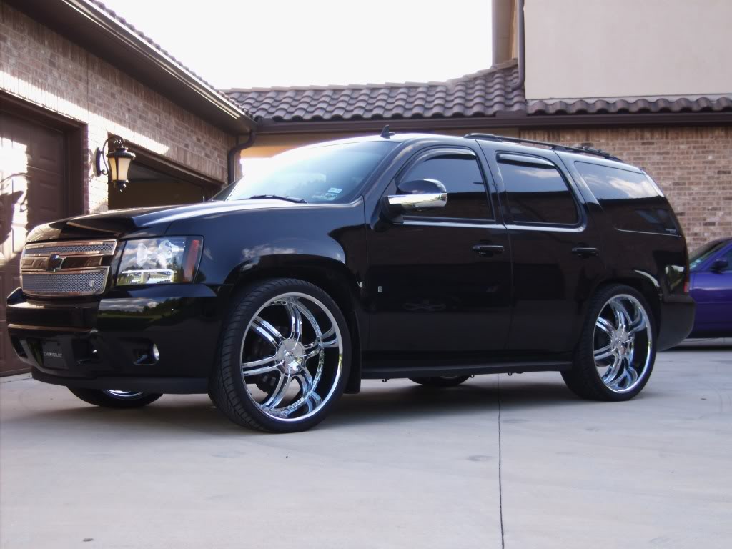

Contrary to what is sad above, when I switched to 24s I barely noticed a ride difference. This could be due to the soft Belltech shocks I had installed, or the quality Hankook tires.
Second, gas mileage loss is negligible. Most 24s mounted on a 295 series 24" tire will way the equivalent of the stock 20s (so a .5MPG loss), stops almost the same too.
I know from experience, so I am not just typing.:Handshake:

Thanks for the input- I'm fine with losing gas mileage, if that's the case. After reading around it seems like the general consensus is that it's not that big of a deal.
I'm pretty set on going with 24's, just want to make sure I go about it the right way to sacrifice the least ride quality, and as far as potholes and curbs go- I'll just have to be more adamant about avoiding them :)
@Modded, that is great to know! Your ride looks great- the rims & tires are really similar to the look I'm going for. I'm going high quality all the way around as well. Well worth it to achieve the final result. Do the 24's rub at all, did you have to modify anything to fit them? If you're an '07 we have the same body style. Thanks for your input!!

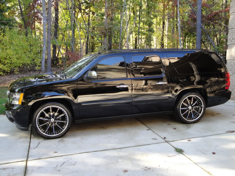

My wife has an 08 Suburban LTZ, similar to your Tahoe except its obviously a tad longer. She transports our 2 kids around in it and its a daily driver, averaging about 14k miles per year on it.
Anyhow, we had the stock 20" Alloys and she wanted to run a 24". We chose to lower it before we got the 24"s on because the wheel well gap is just too big if you leave it stock. So, we put a McGaughy's 2/3 drop on it and then threw on a set of 24" 3pc Asanti wheels. The first set of tires were 305/35/24 but we noticed some slight rubbing when you turned the steering wheel all the way. If you do not have the power steps on your Tahoe (which it doesnt look like you do in your pic) then you don't have to worry about the rubbing. We have since went to a 295/35/24 and have no rubbing at all, although I liked the slightly beefier look of the 305.
As far as the ride. I came from a lowered vehicle life, so I was a little apprehensive about lowering our family wagon and putting a large wheel and small tire on it, but she insisted. To my suprise, it is VERY close to stock. The truck is a tad firmer in the rear, but the front is completely unchanged. We can still go over small potholes, but I wouldn't try to go over a curb. She loves it and gets alot of attention driving it, so I can't complain, it makes her happy.
Anyhow, this is how she looked on the 305/35/24, lowered 2/3, etc. If it makes you feel any better, we're debating on stepping up to a 26" wheel now.
Yeah Christina the 24s rubbed, but not much. Minor trimming got rid of that.
Now that I have 26s though its a whole different story. The front wheel liners are just about gone and it still rubs on the washer fluid tank (normally behind the wheel liner) and the parking brake cable. I also rub on the top of the inner fender housings over dips, thats it.
It gets annoying, but then again I have a 3/5 drop on 26s and a +35 offset. Tire is a 305/30/26.
Rides pretty damn good, except over harsh roads.
