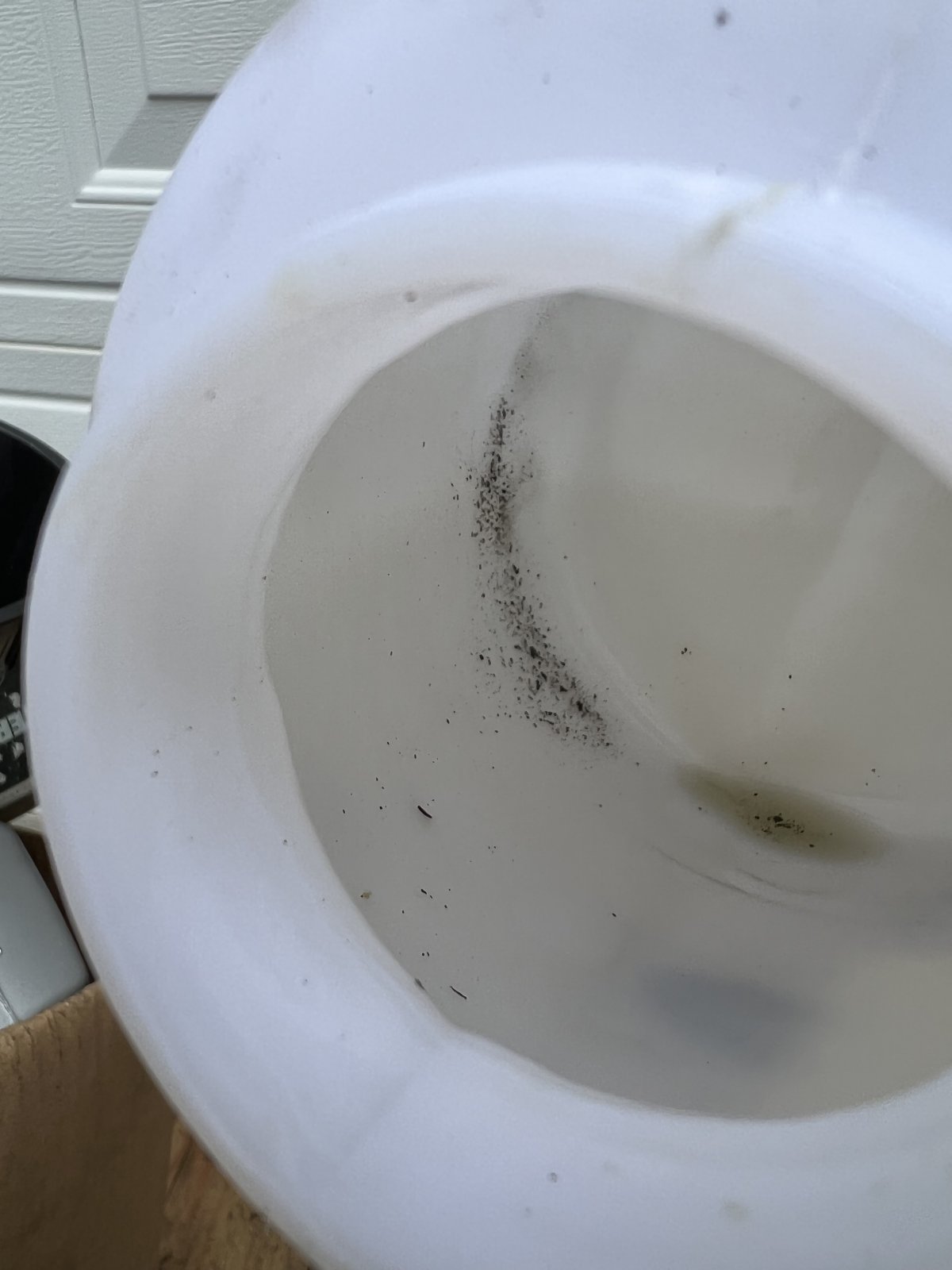

So I flushed out my hard lines (disconnected from the master cylinder, and disconnected one at a time at the wheels). I used some various bits of rubber hosing, my harbor freight vacuum brake bleeder, a bit of acetone, and a copious amount of swear words during the procedure- but here is some of the results.
This is the funk I flushed out.
Here you can see some of the delicious giblets that came out of my brake system. I also hosed out the master cylinder reservoir with break fluid, degreaser, yak jîzz- whatever else I could find that I thought might clean it.
While it got 98% off the crud out, there was still some ****** stuck to the inside that I couldn’t reach.
At any rate- after a long, arduous brake bleeding session, I was rock hard! Well, the pedal was, anyways.

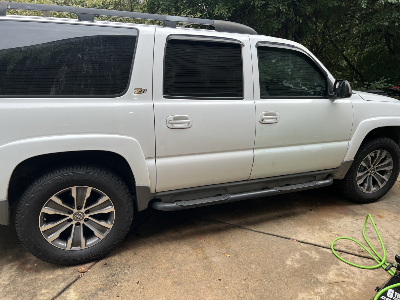

Number deuce- I went to get my tires mounted on my big ugly dubs, and I may have did a thing….
Yes sir!! Look at them squirrel smashers! They’re nissan stock 20’s. They clear the big brakes, and they look way better than the ones that came on the turd.
What y’all think?? Better? They still say Nissan in the center cap.
With the 275/65r20’s (34.1”) there’s a minor touch to the fender liner at full lock, but nothing extreme.

Number deuce- I went to get my tires mounted on my big ugly dubs, and a may have did a thing….

Nice rims. They look 1,000 times better. You could always change the center cap.

Those Nissan wheels look good! Always love a good color contrast between the body of the truck and the wheel! If the Chevy bow tie caps don’t fit those wheels you could always get the right sized cap for those wheels in a blank and have bow ties made up in commercial grade vinyl. That’s how I have Denali logoed center caps.
