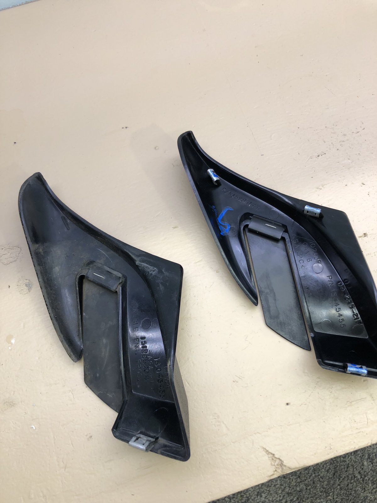

When I did the hood I noticed the DS cowl piece was missing two clip mounts so I ordered a used one off eBay. They want like $60 for a new one. I think I paid $20 for one that’s like new. Good thing it wasn’t the other side, thats an Escalade one with no antenna hole and we all know those are impossible to find now.

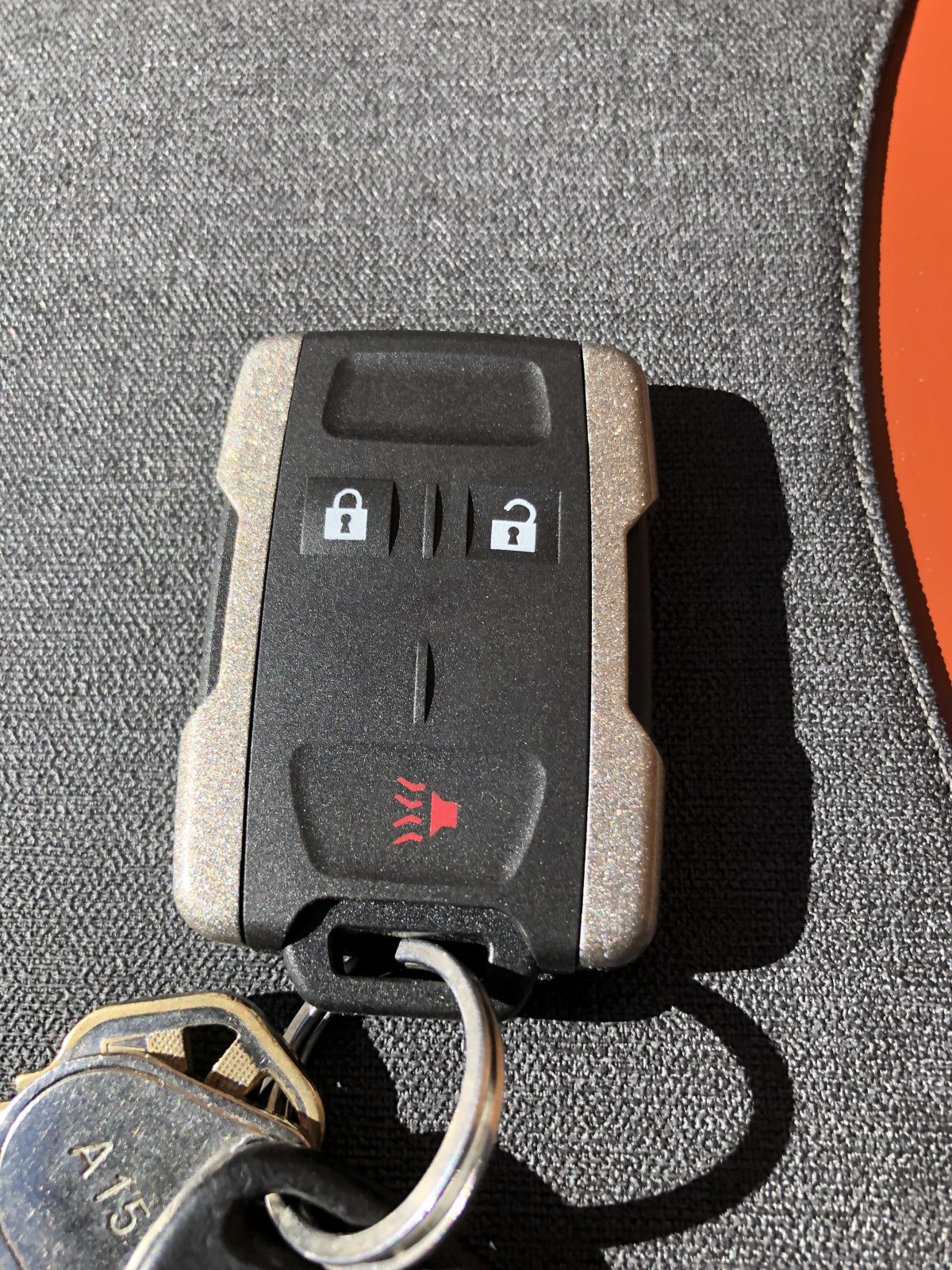

I made a new fob for The Beast. Color matched the metal bands on both truck’s fobs so I can tell which are which from a glance.
