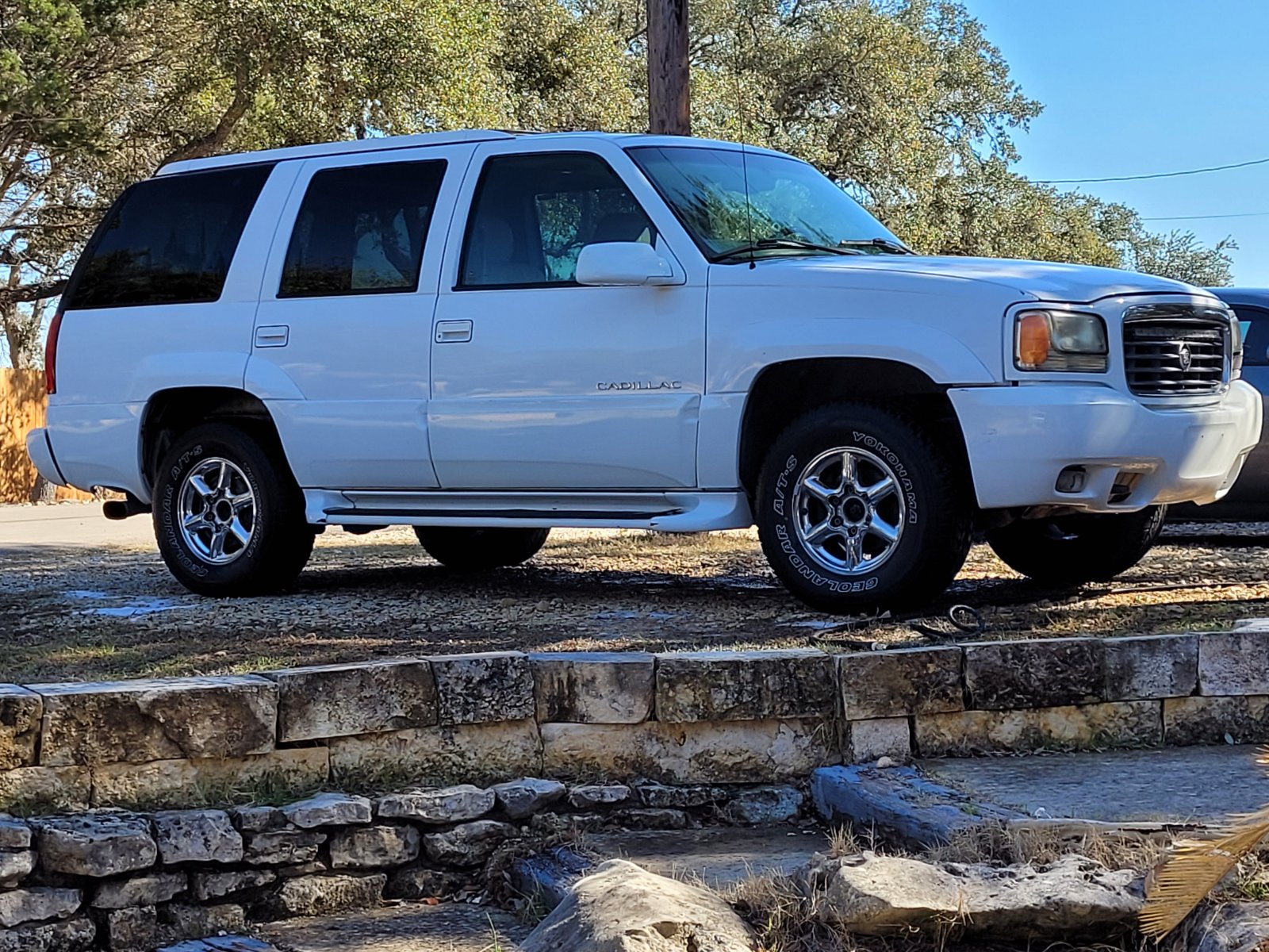

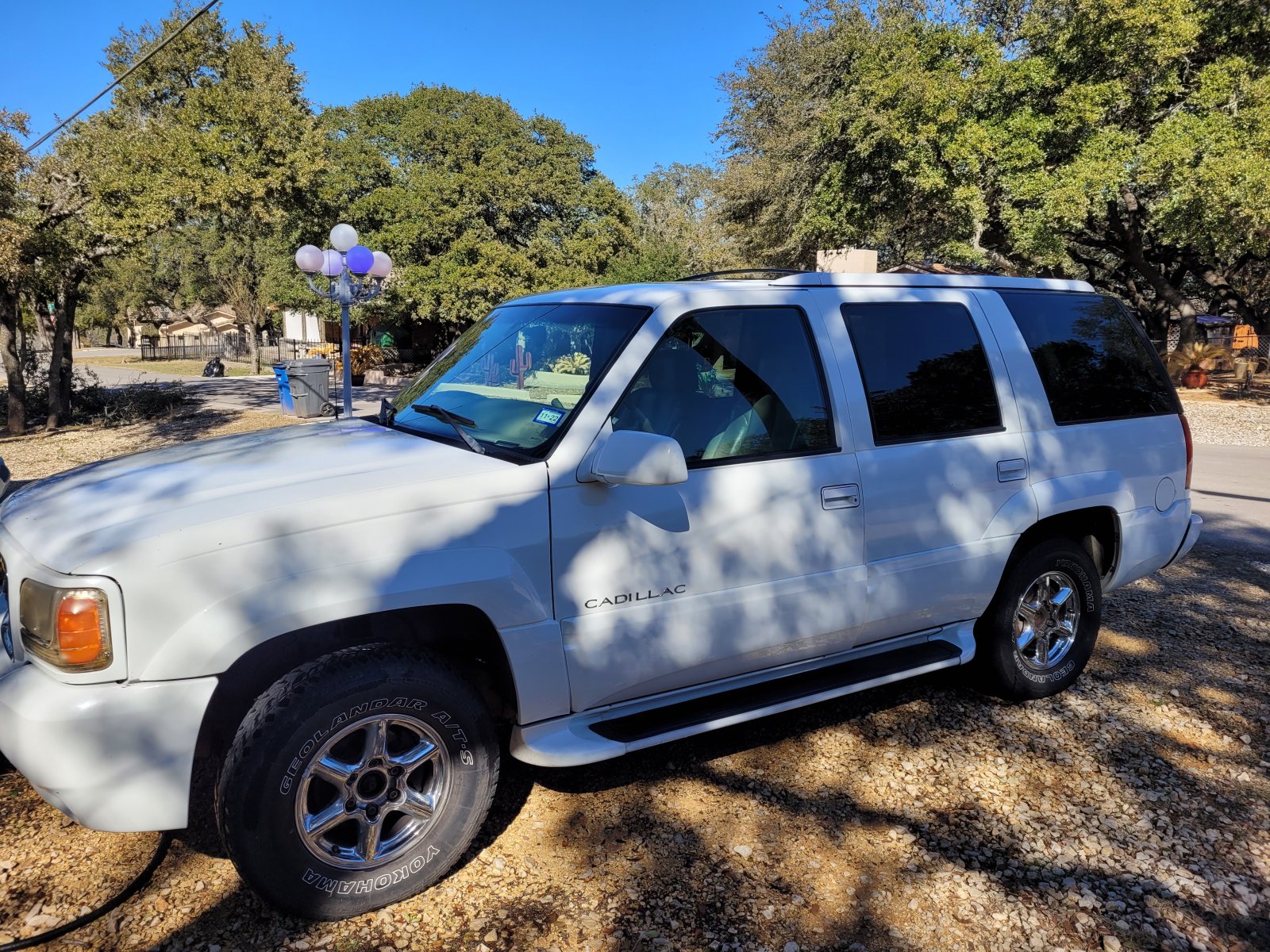

Hi everyone! I got "Immanuel" home last night! I found one spark plug wire that wasn't even on all the way. It improved it alot. Now she idles. It has new plugs and wires. A Distributor cap and rotor arrive Monday. My plan this week as follows:
#1. Pull Plugs Check Gap, take Photos.
#2. Install Distributor Cap & Rotor.
#3. Put her on a code reader.
I want to do this first befote compression check. Cause she has power. Its blowing a very little white exhaust which smells like fuel, like she's running "Rich". She smooths out quite a bit when I idle her up. I'm wondering if there might be a bad sensor or something? I'm going to post a video when I'm done with this post. I spent 3 hours hand washing her. She was extremely dirty from sitting under a tree for almost a year. Here's a list of new parts that was done by the previous owner.
#1. Master Cylinder
#2. New rear wheel cylinders
#3. Plugs and wires
#4. Fuel pump
Amazingly she is clean, clean, clean! no dents r scratches, and you can see she cleans up well. Solid Texas Truck it's whole life! It needs front seat covers. All the electrical works, all the lights, heat/ac and it has a Pyle Receiver that folds in and out and ROCKS! So I'm happy for $800.00 I will "Resurrect" this Esky. Definitely worth it. I just need to straighten out the rough running and ticking. Thanks guys. Video coming next.
