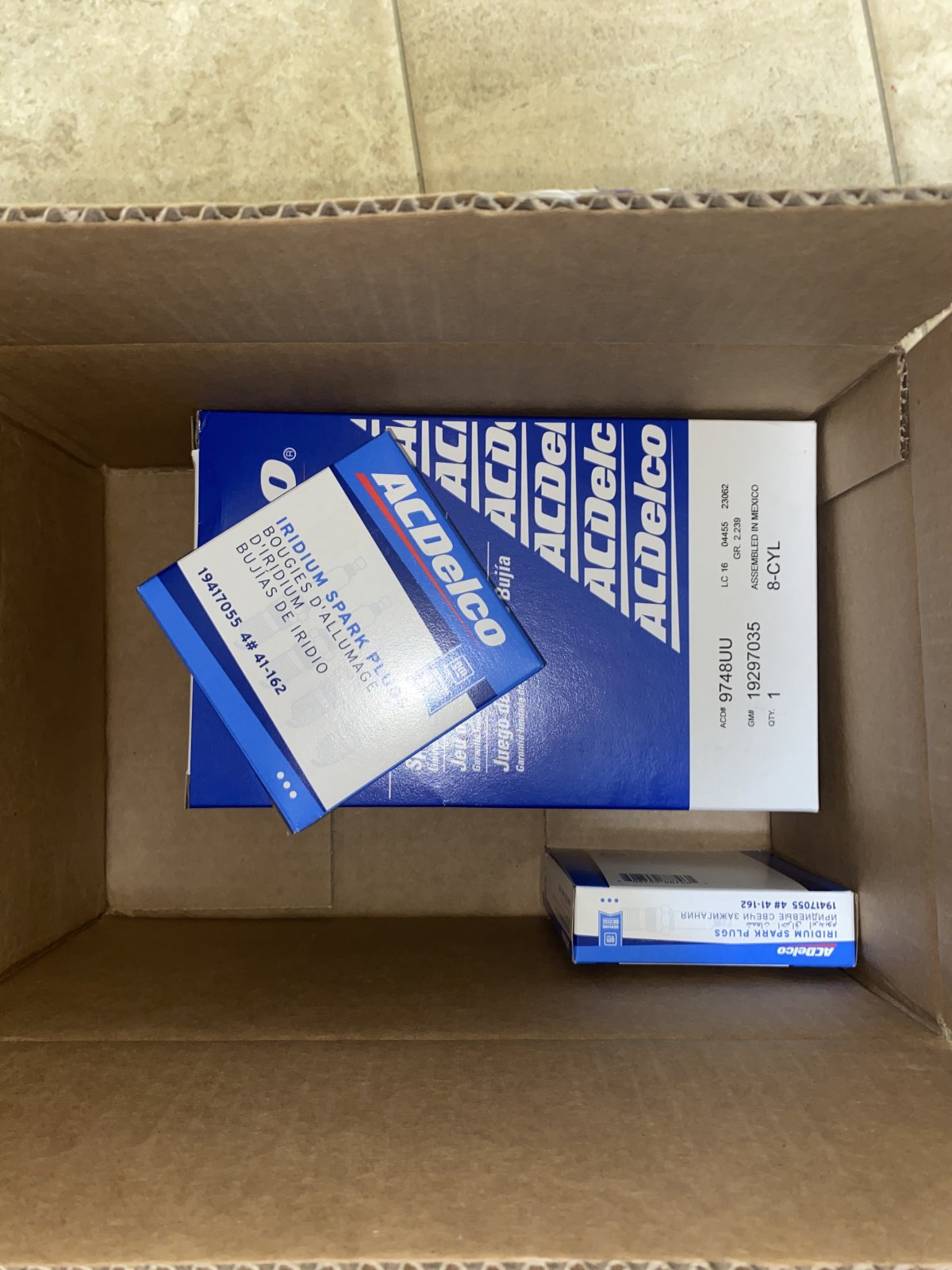

OEM plugs and wires will do wonders for you. Start with those first! I had the same issue. I was having shudders to the point that I thought the torque converter was going bad. The dealership told me my plugs were good ( without looking at them) and wanted to sell me a transmission. I went elsewhere to have the plugs and wires changed. The plugs were bad! The electrodes were worn away on a couple of them. The truck has driven like a dream since then. No more shudders. Like you, before my plugs were changed, e85 seemed to make it shudder less. Nonetheles, stop chasing this and get those plugs. At your mileage, you need them anyway. OEM only!
Heard! Ill be ordering plugs and wires next… I just wasn’t sure bc I haven’t had any codes for spark plugs (usually I hear bank 1 will run too lean)

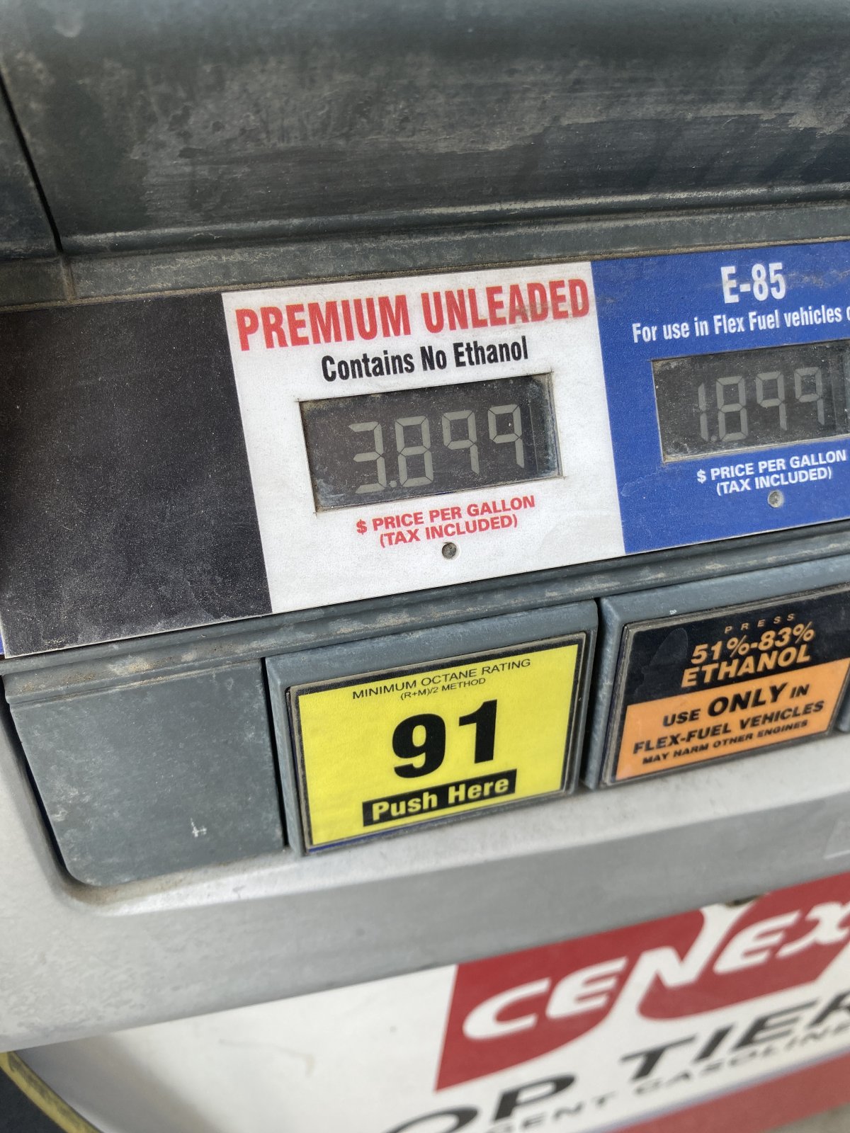

So keep using premium? Seems to last longer. But I didn’t notice the shuttering happening more until after I started using premium. Which makes me want to use e85 again
If you're okay with the price of premium, then you're prime for E85. Roughly calculating, E85 will use 25-30% more fuel than non-ethanol fuel, so your MPG will suffer 25%-30%. If the price of E85 is 25%-30% cheaper than premium, then you're breaking even or coming out ahead. Talk about a life hack!
The thing is, the fuel labeled "E85" are often not actually 85% ethanol. In some places, it is. In my parts, it averages 60%. So, I wouldn't need the price of E85 to be quite that ~30% lower than premium to break even. Maybe only 25% less to throw out a figure. Even if you don't break even or better, it's okay cuz the fact that it's cleaning your fuel system and combustion chambers has value. So, enjoy the cheap gas and ignore the MPG.
If you have easy access to E85, run it for a few tankfuls and see if there's any difference. When your tank gets down to around 1/4 or so, dump a can of Berryman's B12 in it and drive it down to 1/8ish and refuel. Do this as often as you want.

I wasn't gonna get that deep into the maths, at least, not right outta the gate. But, yes, the benefits have value and I agree that it would still be worth it even if it wasn't a wash, financially. There's also the fact that the "E85" at the pump might not actually be 85%. Didn't wanna scare him off by dumping all the info at once. :p I think he's still with us.

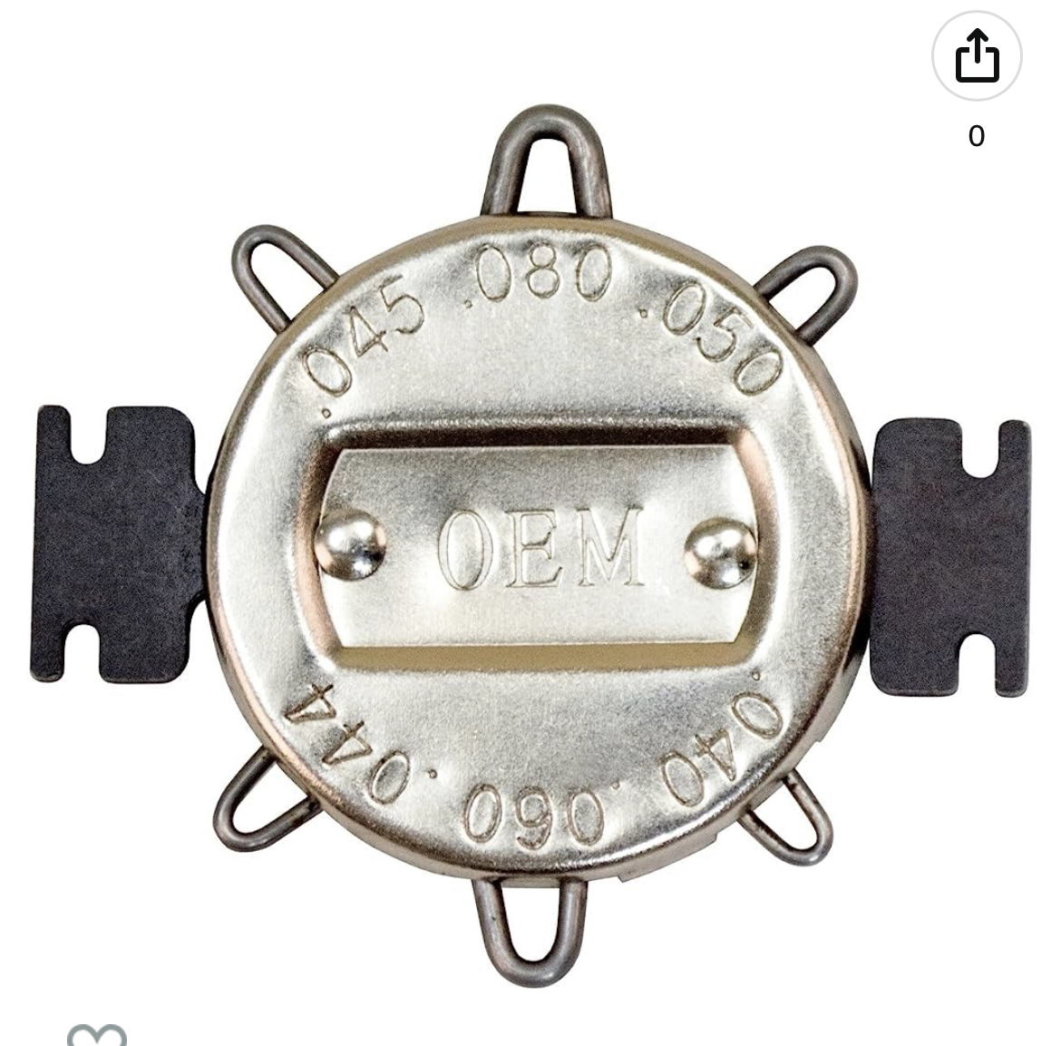

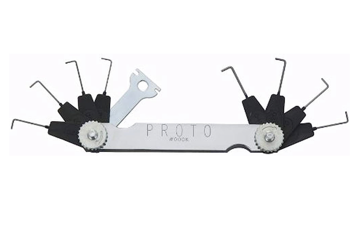

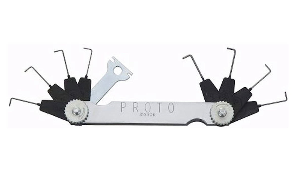

If you buy plugs, check the gaps. They say you don’t have to gap them but almost every one of my AC Delco plugs I bought from Rockauto were gapped at like 15-20, instead of 40. They tell you to return them and purchase new ones but that might take a while, with how many are not correct.
44,967
And BE CAREFUL when doing so. You can't check and adjust them like you would with an old school copper plug with the fat and sturdy electrode. Really, just avoid touching the electrode beyond a very light rub with the feeler gauges. DO NOT pry against the electrode to open the gap.
I'll take this opportunity to say that I've never had an NGK plug not gapped at its advertised spec.
Yep. just lift up on the tip lightly until you get it where you need it. It’s not hard to bend it.
It almost never is. It's somewhere between E51 & E83, depending on where in the country, as well as when in the year; ethanol will never start up or warm up an engine as well as gasoline.
