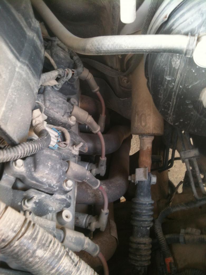

Look for box like objects(bigger than the exhaust diameter) welded into the exhaust after the exhaust manifolds. One on each side. If its straight pipe/ hacked pipe, the it has been tampered with.

Those 4 tubes are part of your exhaust headers. once they go underneath your truck, they should go in to the catalytic converters. take a pic of those 4 tubes from underneath your truck and follow them back.

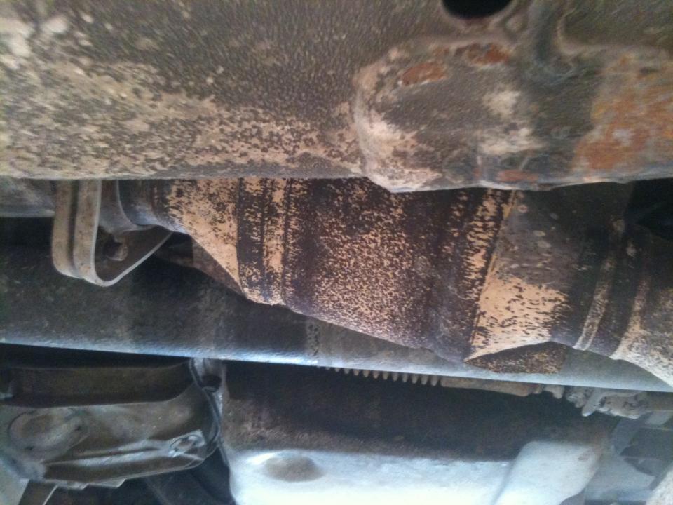

Those are some longtube headers, most likely you do not have cats in your exhaust system, and the rear O2 sensors most likely have not been turned off to not report to the ecm hence the DTC P1133, 1153.
As for the noise of (like pebbles in a metal biscuit tin!) it is probably related to pinging or detonation due to an improper pcm tune to adjust for the aditional airflow created by the cai and headers.
Good luck finding a good tuner, maybe look at purchasing an Autocal by EFI Live and have the ability to datalog and email them to a tuner back here in the States, then they could email a tune to you and you can dowload it into the truck...I would highly recommend BlackBear Performance who is also a supporting vendor on this site.

I crawled under the car this weekend and managed to get the attached picture. This is the only thing bigger than the exhaust diameter I can find.
