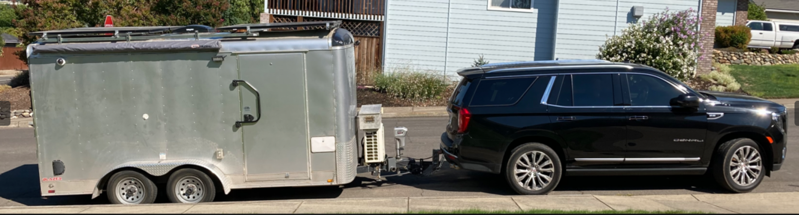

Picked up the new Winnebago today!
Haven’t received the Anderson WDH yet but looks like i’ll need it.
In this pic about 440lbs on the tail. 3800LBS trailer weight.
The towing performance I find underwelming on the 5.3L
it’s probably programming related but is sits in 7 or 8th gear / 2500 RPM a LOT. does not use the torgue at all.
Likes to gear hunt.
Transmission steady at 155F

Why do you need to take it slow up the hills. Can you not keep up with the speed limit at times ?
Likes to gear hunt.
Were you using tow/haul mode?
Likes to gear hunt.
I'm surprised at this. Your trailer weight is nearly identical to the boat I tow and I find the 5.3L more than adequate. As @StephenPT asked, were you in tow/haul mode?
Honestly, I think the 5.3L doesn't get enough love. It's a great engine in my opinion.
