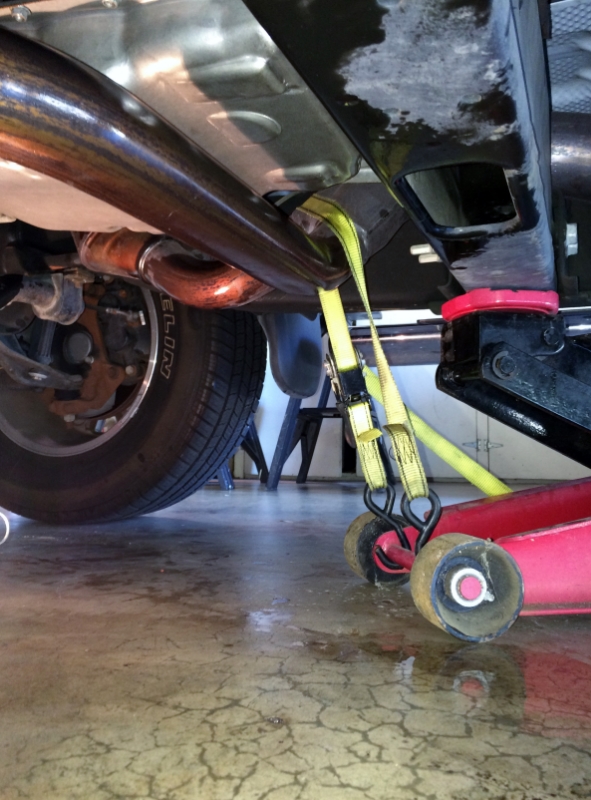

Now myy Denali has 30K on that oil, so it is time to do it again. However, my experience with the exhaust pipe in the way was so difficult that I thought I'd research it a bit before I crawl under the truck to go at it again. I'm not a fan of paying someone $250 bucks to change my tranny oil....
So, could someone please confirm that to remove the transmission oil pan from a 6.2L Yukon XL Denali the owner has to remove the right side exhaust manifold from the block? If so, WOW. That's no easy task. The exhaust manifold has 5 or 6 bolts and the back 2 look like they will be a BEAR to remove, due to how close they are to the firewall. I'm sure, due to block heat, all will take serious torque to get lose. I don't want to even do this if I don't have to.
Please, could someone tell me if there is another way? If not, I'll be sorely disappointed in the engineers who blew this design. They need to go back to school and start over if this is the case.
