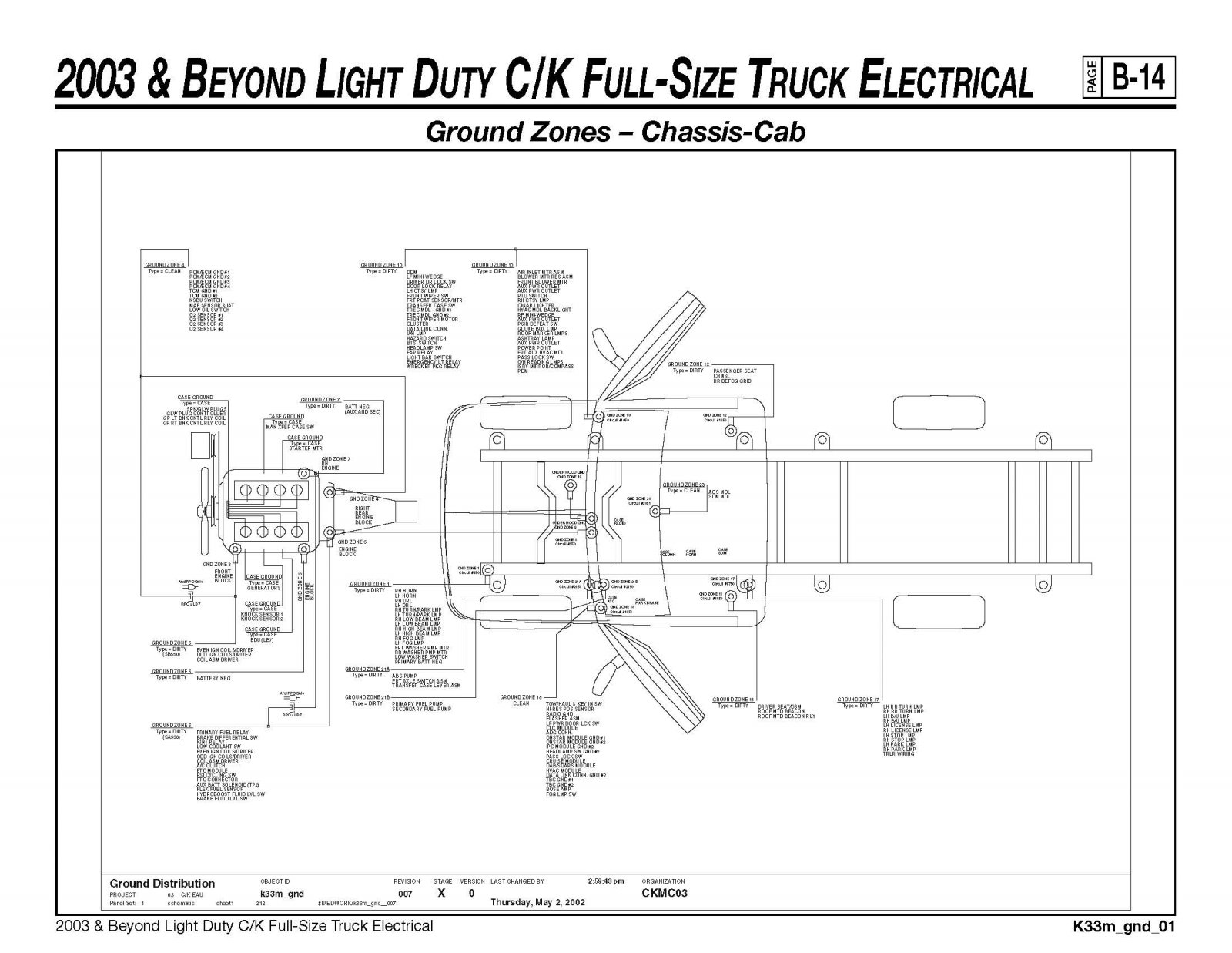

Does anyone have a good schematic or pictures that shows where each ground is that could have an impact on the 4wd system?
Hobert
Jan 6, 2019
280
628
Downers Grove, IL
Here is a ground schematic. I can get you a higher resolution.
