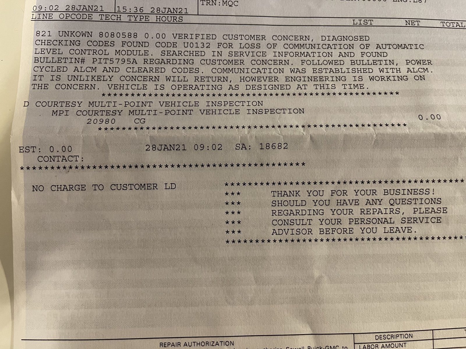

Got mine back , it was just a reset but speaking to the service tech they aren’t sure what the real issue is. I’m back at normal ride height now and plan to leave it there . CFD41EAB-59BC-4822-9673-F0D78C19045F.jpeg

Were you lowered? If so, how low? Which links?
