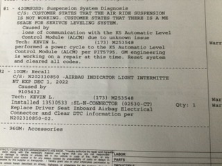

I’m taking my car back in this Monday. When they first returned my car they basically did a system reset on the ALCM and communication was established again. However, when I walk up to my car it no longer lowers down and raises anymore for entry/exit. I also feel like the ride itself is not as smooth anymore and if the air suspension is off or now in normal mode? I was told they may have to flag a diagnostic claim straight to GM. This is so frustrating to have a new vehicle and now dealing with the air ride feature. I called multiple service GM dealerships today to see if anyone has figured it out? Sounds like GM Engineering is working on this problem and we may have to wait it out.
