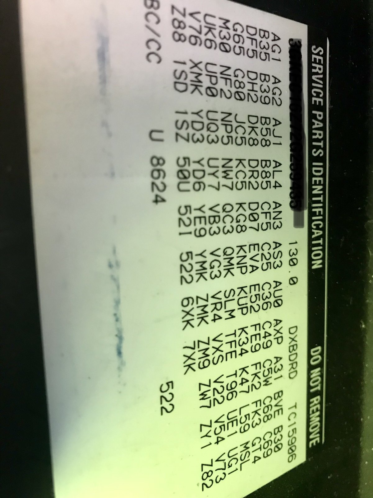

This is what rockauto.com shows; only 4 that I know of that make them. If you want to be certain you need these look at your RPO list in the glovebox, it's a sticker with a bunch of 3-digit codes on it. You're looking for ZW7 & G65. If you have both of those you should have these shocks or you should replace your rear coil-springs if you want to use another shock type.
