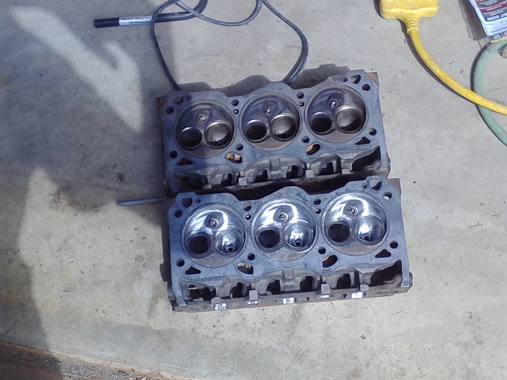

I never tried it, but I’m tempted in my 2014 Sierra. I always thought the lower mpg made it a negligible cost savings
It depends on the cost of E85. Sometimes it's a saving, sometimes its not.
However, independent of cost, it might be worth running a few tanks of E85 back to back every few years. Ethanol is extremely clean burning and does a great job of cleaning up carbon left behind by E10 fuels.
This is after a 3k mile run of e85. Clean as a whistle!

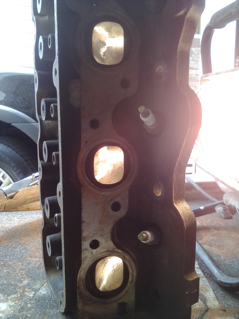

I did some more reading into this. Found a head after a year and a half of E85. Definitely seems corrosion is a valid concern. Also saw some dyno videos on youtube where E85 cooled the intake charge so much the supercharger built condensation on the outside
And here's from a block off a different vehicle. Seems to support the corrosion issue in a DD scenario.

So, my conclusions are this: Run a few tank fulls every couple years to take advantage of the cleaning abilities of E85. However, due to an increase in wear and corrosion concerns both with the engine internals and metallic parts of the fuel system, I wouldn't find it suitable for daily use where long term vehicle reliability is a concern.
