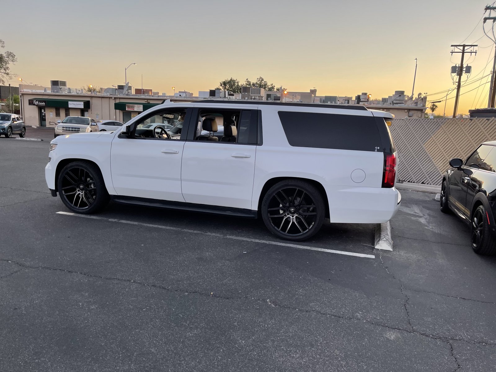

2016 rear 2” level on 22s
What wheels are these?

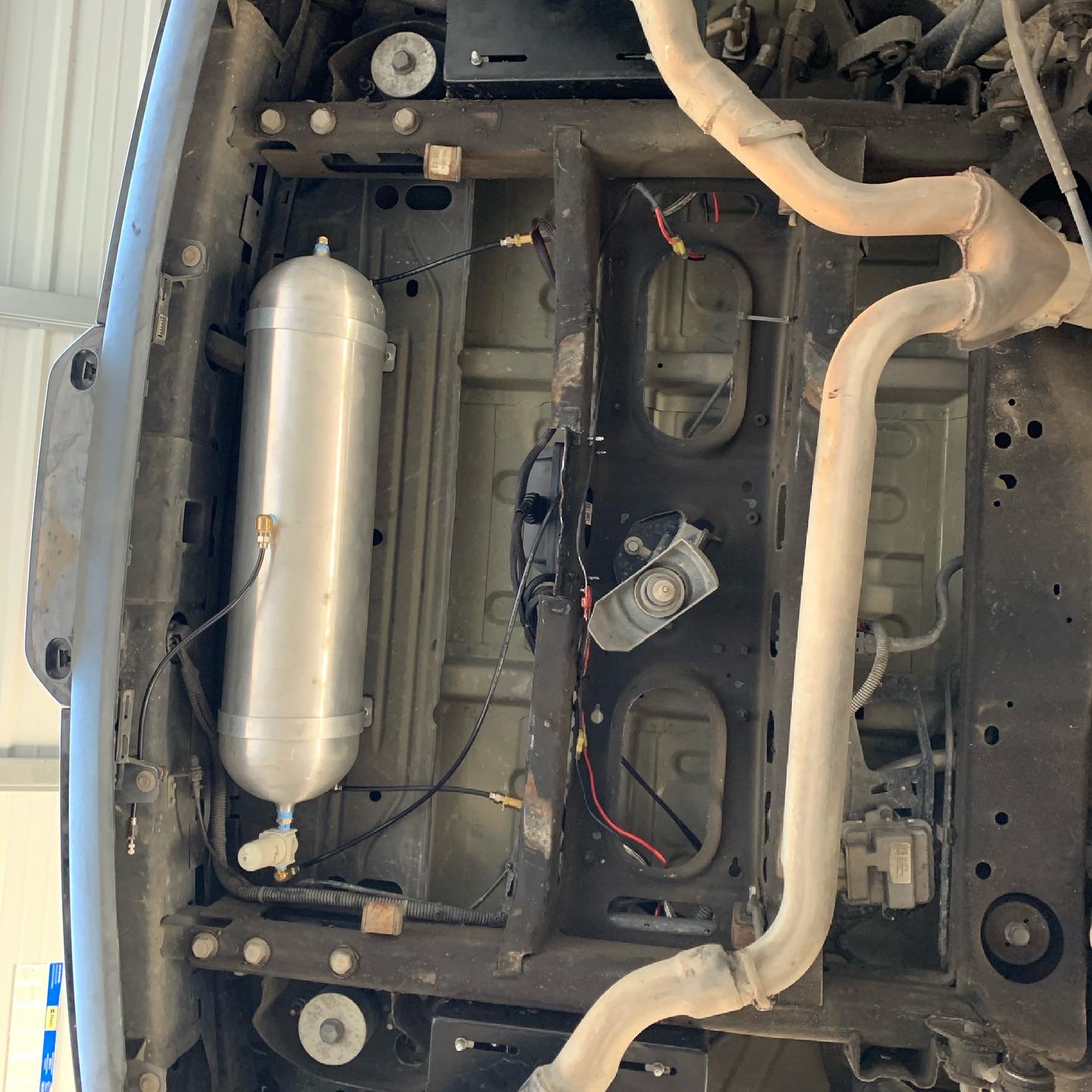

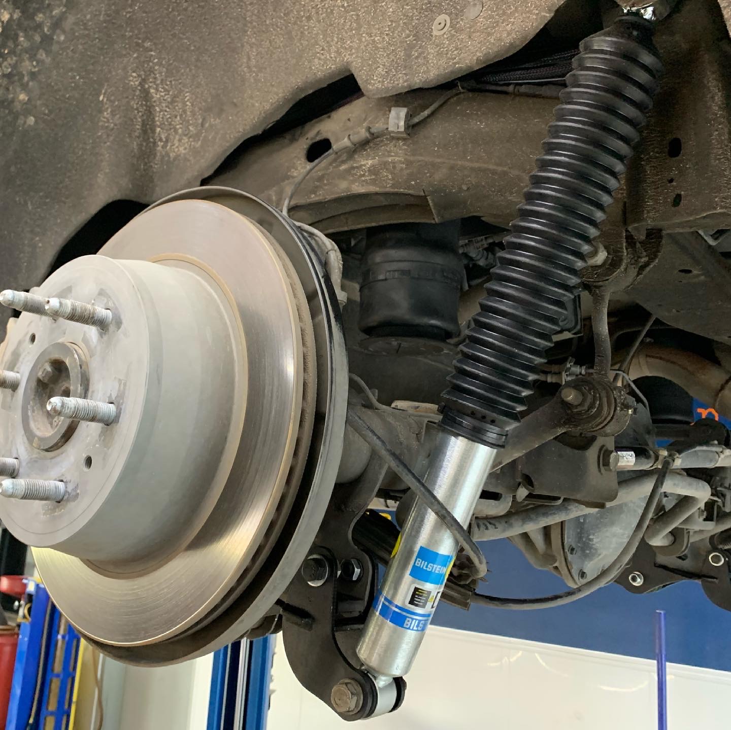

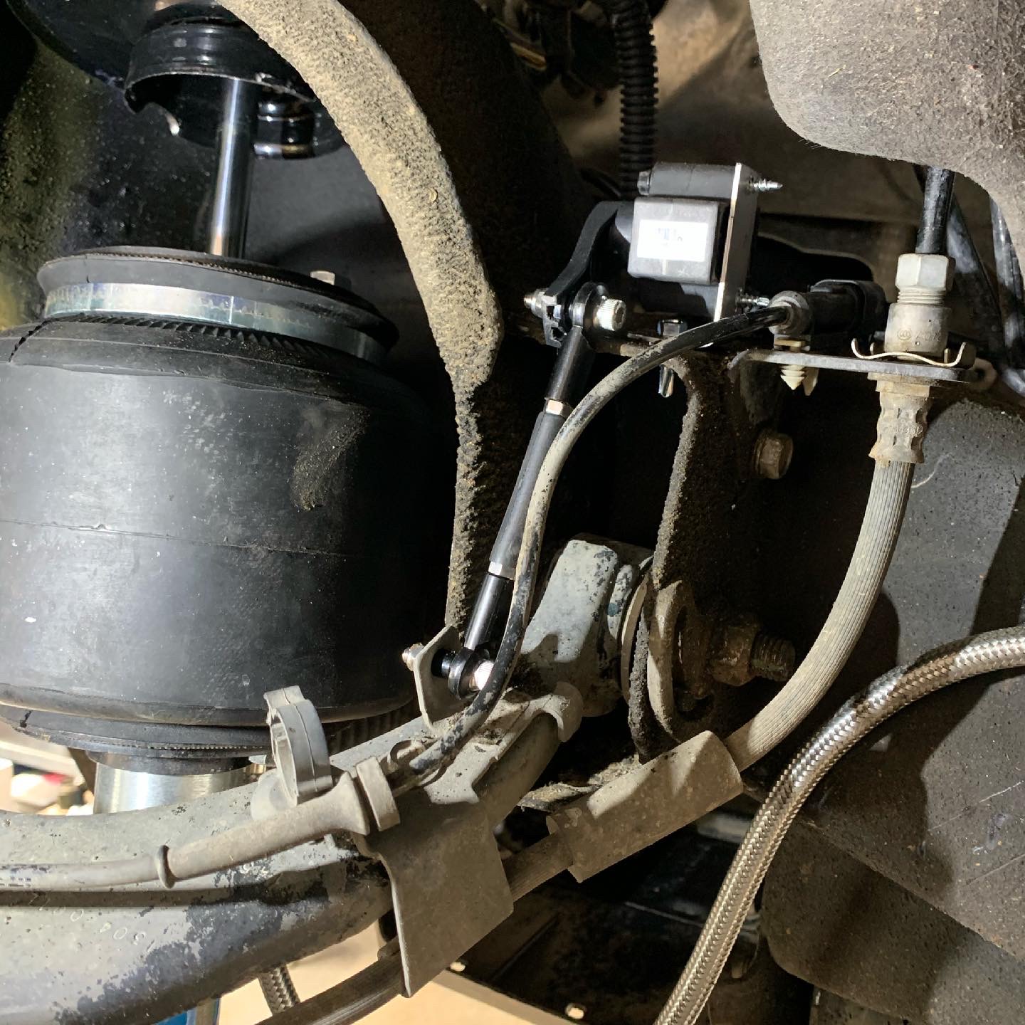

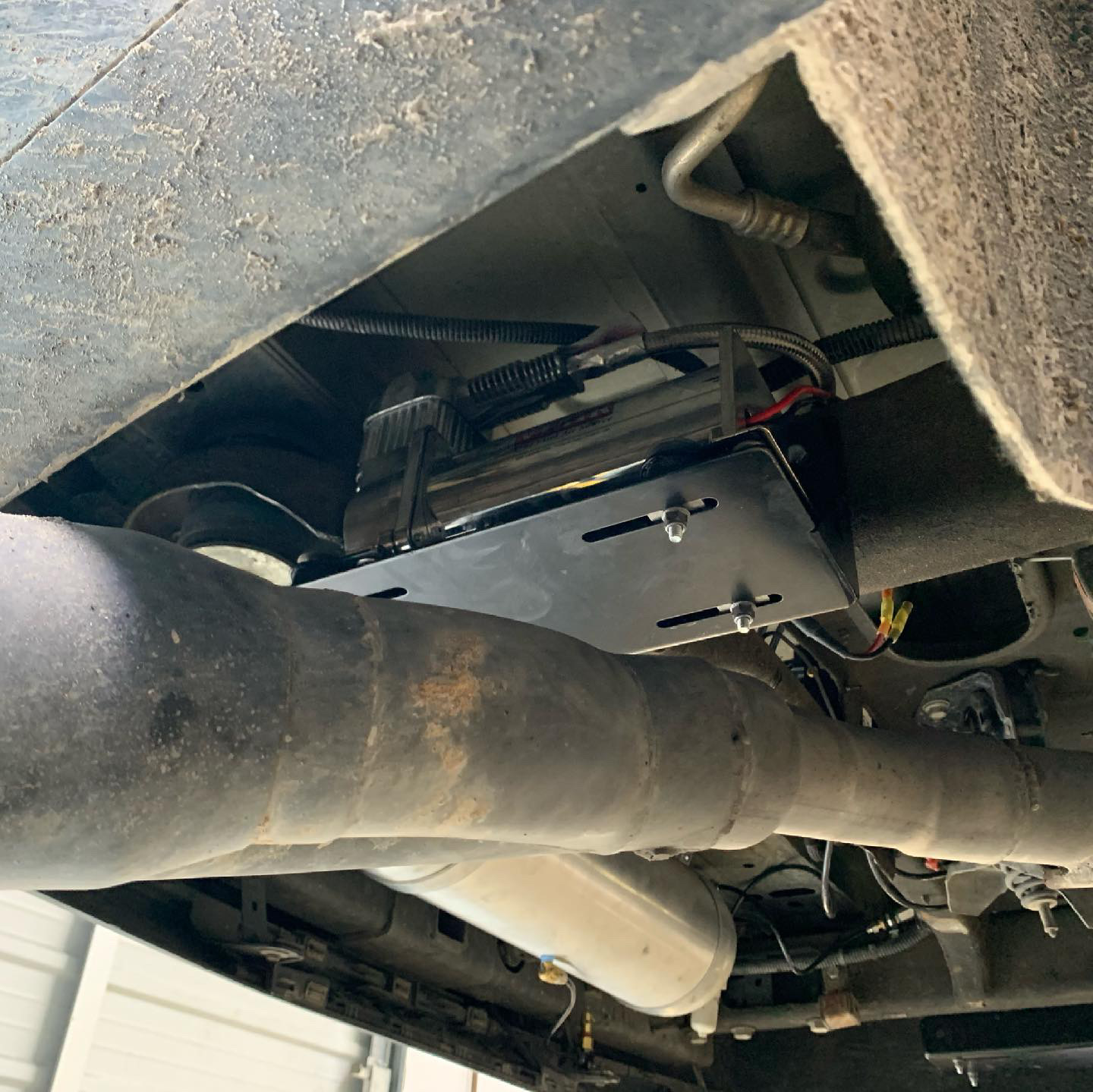

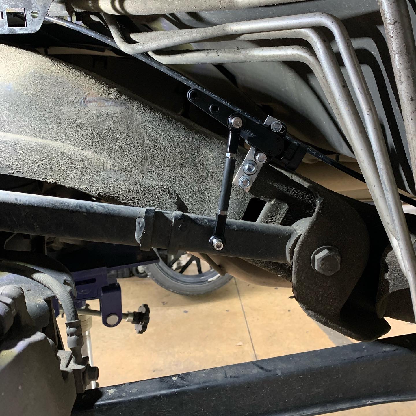

Made some length adjustments to the ride height sensor links and got it close to perfect. Tony’s 2” rear drop and still sits nice with a fairly heavy trailer, but the pump doesn’t turn on under normal conditions (no trailer and just me, the wife and kid). It seems to take about 150 lbs in the rear to kick on the pump, like when my niece and nephew jump in the 3rd row.

You have misinformation. You can lower (or raise) with max trailering—just need to adjust the end links for the sensors. I have max trailering and have lowered the rear 2”.
