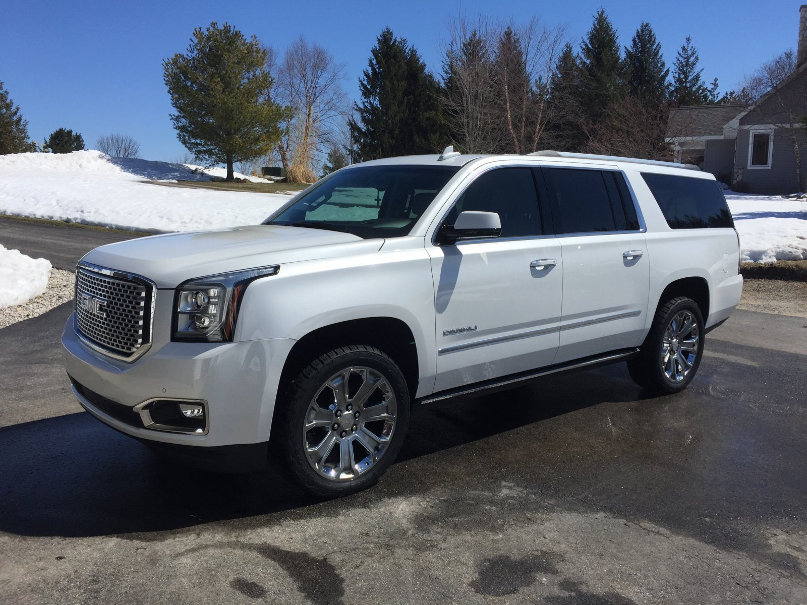

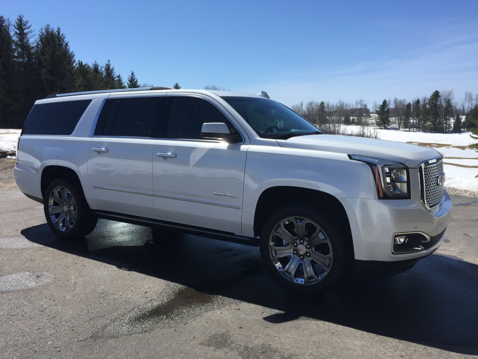

Bilstien 5100 leveling shocks on all 4 corners and a 0.75inch daystar rear coil spacer. 285/65/20 BFG AT KO2 tires on 20inch denali rims.
SteveMansur
Sep 26, 2015
67
16
Looks great! No rub with 34.5” tires?
Thanks! Only rubs on aboslute full lock if you are in a tight parking lot. On the road it doesn't run at all, and off road only in extreme articulation, nothing major though.
SteveMansur
Sep 26, 2015
67
16
How much did it raise the front end with the 5100's?
Not much, Bilstien says it should raise the front by about 1.75inches. After 20,000km on them I feel they sagged down slightly. It still has the tipped forward factory look (just lessened slightly). I previously had a rough country 2inch spacer on the front and fealt it was significantly higher up, but if need be you just get a suspension max kit with strut disks to fine tune how much front lift you want (might do that soon).

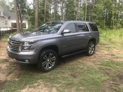

Just picked the Tahoe up last week. 2018 LT. Painted the front grille, emblems, took lettering off, 2.5” pro-comp level, 18” Fuel Anza with 275/70 Nitto Terra Grappler
