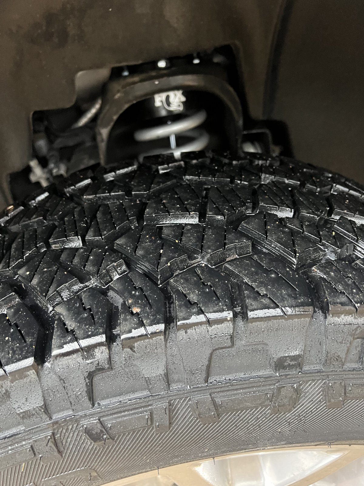

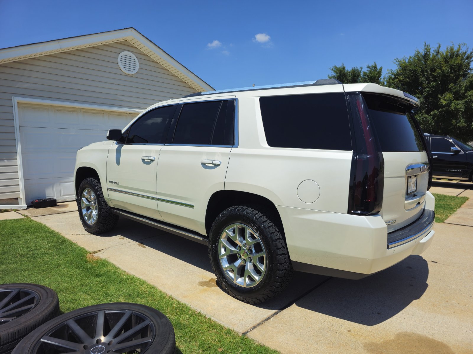

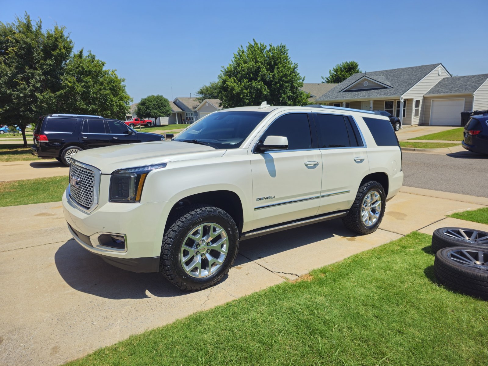

2”/0.75” & 265/70-18 Falken Wildpeak AT3W (32.6”)
Level was obtained with a 2” Rough Country (billet aluminum version) w/Daystar 3/4” rear coil-spacer (KG09103BK).
I went with this tire size over a few others to run a standard load tire - keeping the weight down - and factory width maintains zero rubbing. At some point I’ll get around to trimming the front lip.
