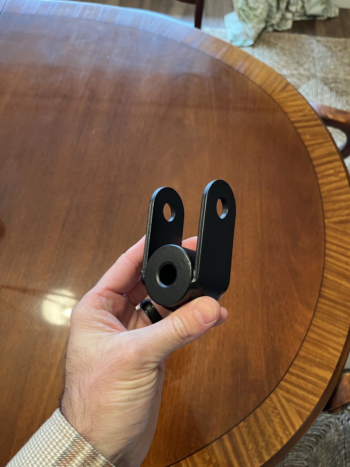

So my truck had a little too much squat after the 3” Cognito/fox front lift and only a 1 inch spacer in the rear. I ended up ordering the dobinson’s rear springs to provide 2” of rear lift to level everything out.
Unfortunately the fox rear struts that came in the Cognito kit are only made for 0”-1” of rear lift. So my options were, buy new longer rear struts and get rid of the brand new ones I just got or install shock extenders.
So I purchased the ready lift 2” shock extender for the rear struts. Does anyone know if they are supposed to install on the top or the bottom of the rear strut? I have called ready lift twice and got a different answer both times.

It shouldnt matter…seems like it would be a bit easier putting it at the bottom…

@Tahoe_Rx weird, looks like the Readylift instructions say to mount on the top
@BigBoyZ71 thanks. They didn’t include any instructions and couldn’t find anything online. Found a YouTube video showing install on the bottom. Then I called ready lift to confirm and they said to install on top. Which left me confused with conflicting info so I called again the next day and that guy told me to mount in bottom haha.
Springs came in so I will be installing in the next couple of days. Installing on bottom would definitely be easier, just don’t want it to damage shocks or negatively impact ride for some reason

@Tahoe_Rx -> I believe that you want to install the shock extensions on the bottom of the rear suspension.
For the trucks, the extension bracket seems to go on top. Another way of looking at it, the extension bracket goes at the end of the shock with the widest diameter, not the end with the rod.
Since the truck rear shocks are mounted opposite our SUVs, IMO, the extensions should be mounted opposite the truck and therefore mounted on THE BOTTOM of our SUVs rear suspension.
