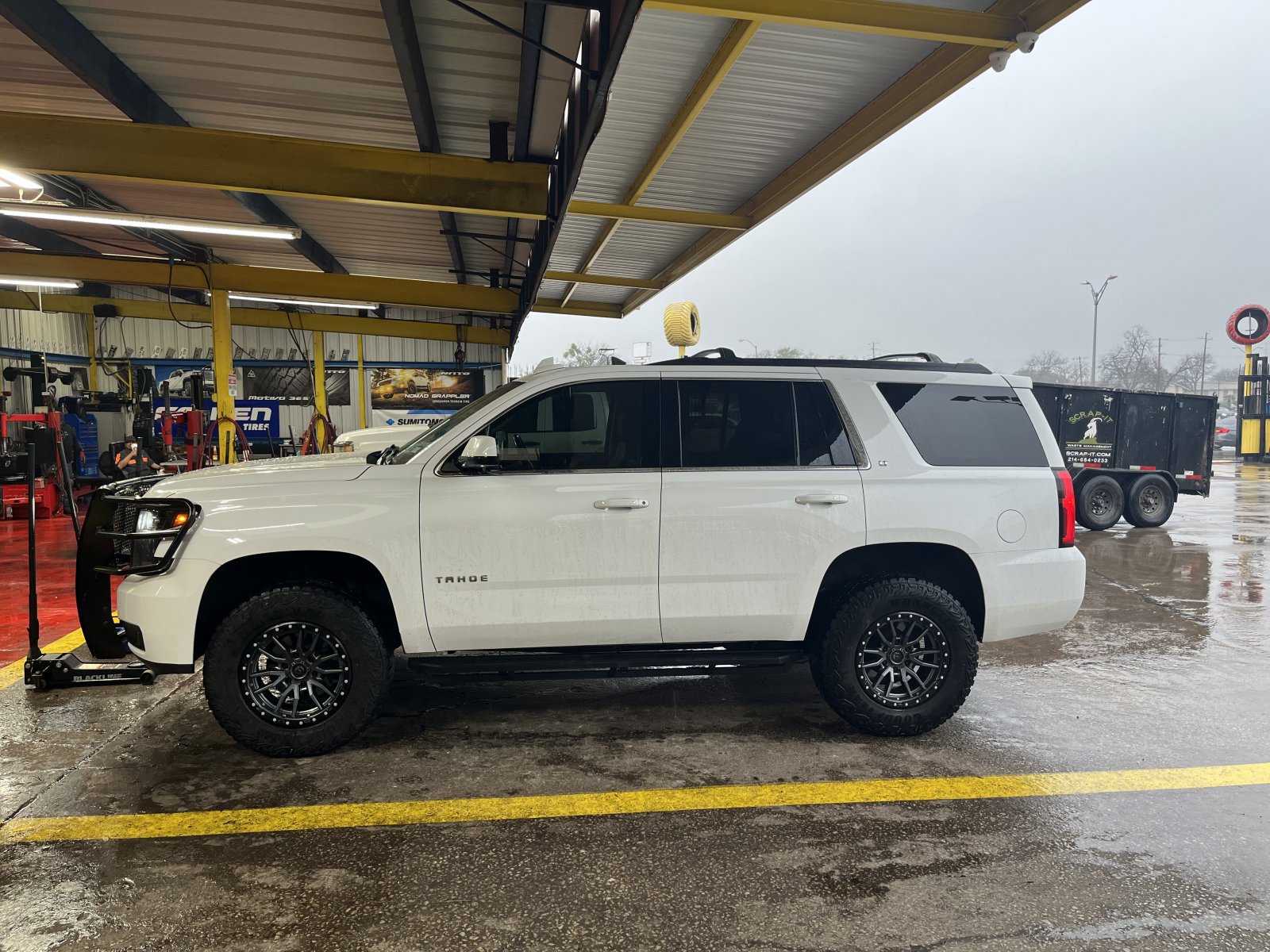

2” front level with 1” rear spacer. 275/70r18 on fuel rebel 6 18x9 with -12 offset.

Yes, I have an ARB compressor mounted in the spare battery tray under the hood. Have an 8 gang aux beam switch near the headlight control on the dash to control light cubes, light bar, reverse lights and air. The brush guard is from Steelcraft. I will have to look back through emails to find who made the side steps. But I have had them on for a couple years and have been very pleased.Looking good! Well done on the overland build. More mods planned?
Have you used the onboard air compressor? What are you airing down to off trail?
Also - what's that running board you've got there? A little hard to tell, but it sure doesn't look like OE...

Also planning to change out my spacer leveling kit for the Cognito/Fox 3” lift/level kit. It uses new UCAs and Fox 2.0 coilovers and rear struts. Hope to have the suspension changes done in the next month or soLooking good! Well done on the overland build. More mods planned?

Pics or it didnt happen lol jk.Just had the Cognito 3” lift installed with Fox 2.0’s and man is it sweet. Ride quality is incredible. I regret not doing it sooner. I will upload some photos tomorrow when it is light out.
I had a 2” level installed before (spacers with stock struts). Not sure if my factory coilovers were just worn out and it had basically settled back to a stock height or what. Because I actually gained 2.5”-3” of lift compared to my stance with the spacers. I measured from ground level o top of wheel well through the center of the wheel. It sat at 38” high with the 2” spacers. Now after switching to the fox coilovers from Cognito it is measuring just under 41”.
The kit included Fox 2.0 rear struts as well. They do not provide any rear lift but I already had a ready lift 1” spacer under the rear springs from my previous leveling kit. It is slightly higher in the front than the rear but isn’t to “dog dragging its butt”. I have a decent amount of weight in the front so I’m hoping as the coilovers settle in it will be pretty even front to back.Pics or it didnt happen lol jk.
What did you do for the rear?
Here is a teaser. I will pull it out to get better photos later and post a new thread as I don’t think anyone has done a complete write up on this kit for the 15-20 trucks on here yet.Pics or it didnt happen lol jk.
