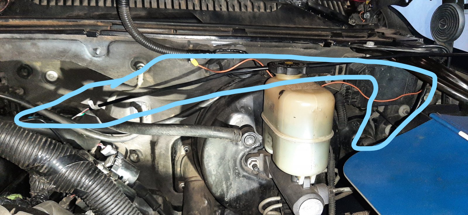

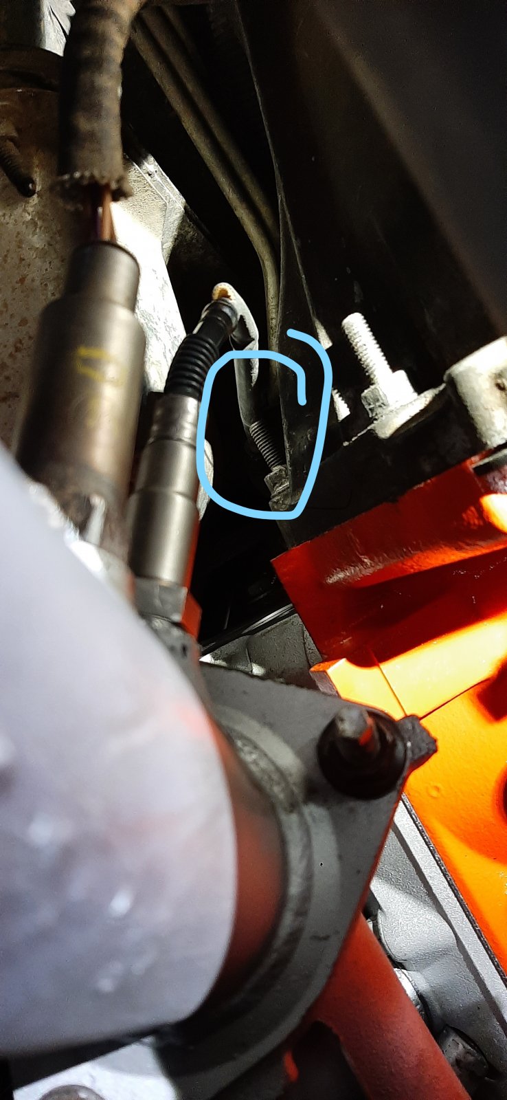

ive got my sensor mounted near the trans iirc, its the most open area to get a drill to. its supposed to rain all day tomorrow, but i could get a pick for ya Monday.

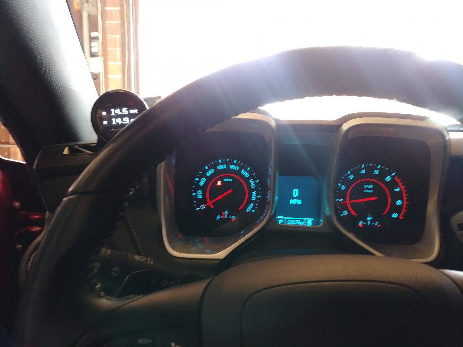

i dont even see mine any more, you know unless im looing at it. tahoe wb.jpg

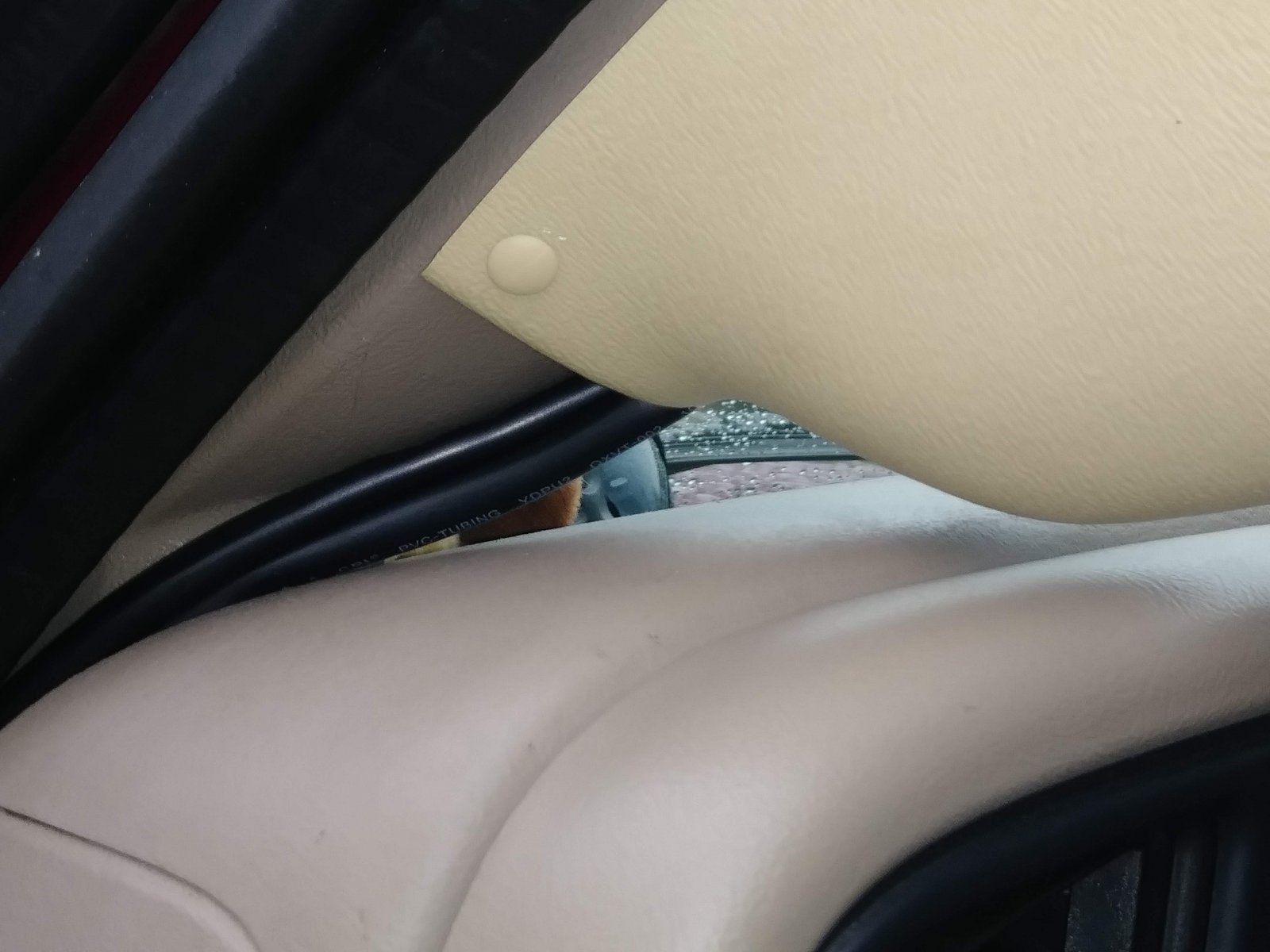

i didnt have the heart to drill a large hole in the A pillar so they are just tucked in down the side of the dash to the fuse box.
that pod is for a Silverado, i painted it. it comes black.

How did you route the cables to power the wideband? You have to power it from the gauge right?

power comes from the fuse box. used a add a fuse. sensor wires goes up and over the engine top to a hole in the d/s fire wall, then routed to the a pillar.

i put a innovate dual wideband in my ss camaro. had one in my regal too. pretty much if im tuning my cars, they get a wb installed. my camaro is gonna be running meth injection on day soon, so having the wb mounted is a must. the regal was on meth too. nice to see it go lean should the meth pump quit. little bit of a heads up to let off asap lol
