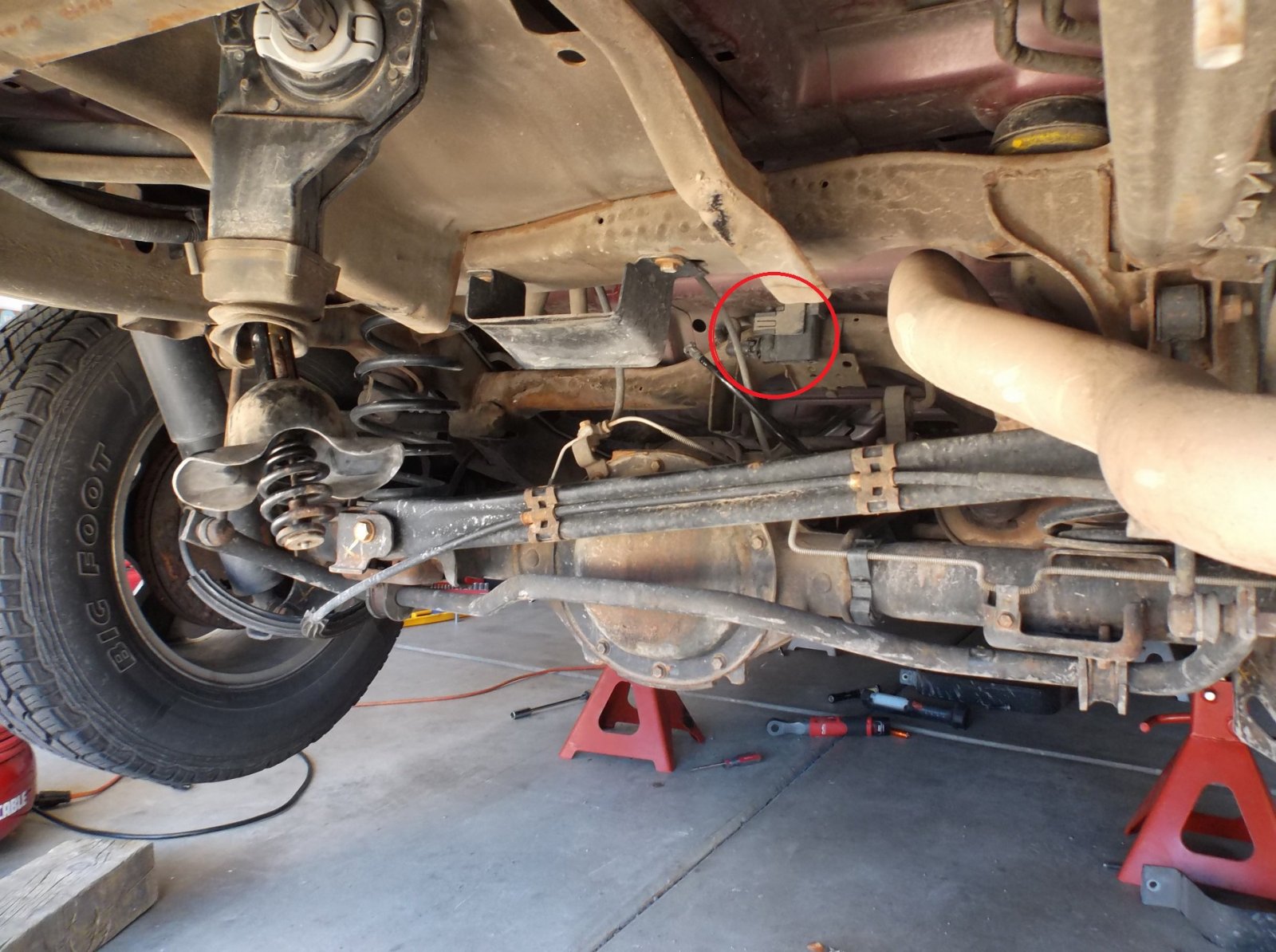

It will help your smoke test to have the system as closed as possible. You can apply 12v to the connector on it to close it, polarity doesn't matter as long as it's out of circuit. Here's a pic with the evap vent valve shown and circled in red (spare tire and fuel tank removed for clarity):
