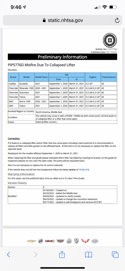

I think it takes a TSB, recall or some other kind of “program” before everything that might be suspect is changed. Mine had new pistons and rings installed largely on GMs nickel under the AFM oil consumption TSB.
