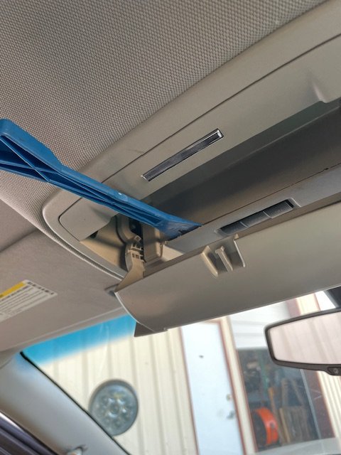

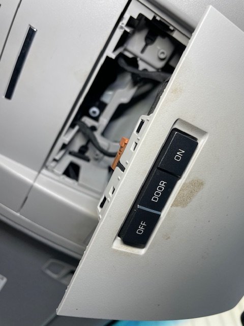

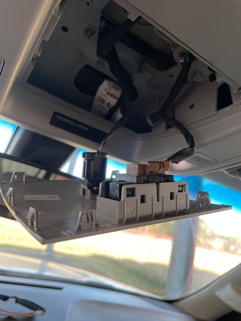

I just had the same issue, my wife and I were arguing what side the rolling sound is coming from in the dash. Luckily, after searching this forum and a few other sites we discovered the problem is in the overhead console. A screw or screws fall on the backside of the overhead console cover. Let down the sun glass holder and pry the rear clips loose and sure enough I had a screw in my overhead console cover. Problem solved. There are videos on how to remove the overhead console on a Tahoe which will show you how to pry the cover off.
