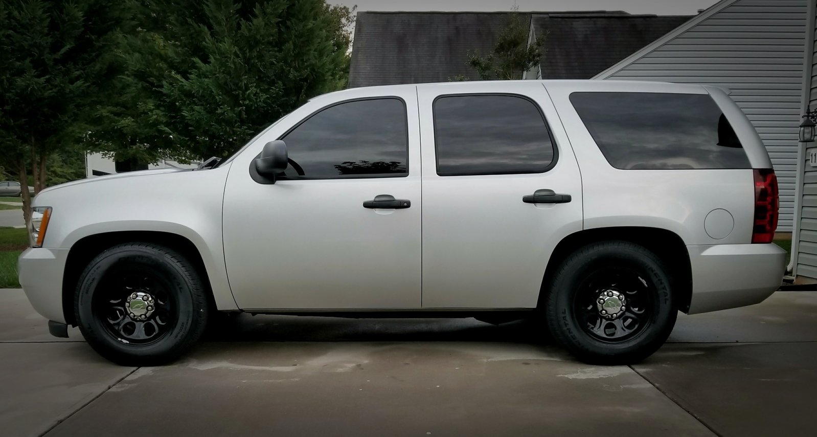

Welp, I'm all done for now. Pretty damn stoked too. Huge thanks to @NORCAL SS for the help ordering and along the way during the install. This thing drives like a damn dream!

HOLY SHMOLY, THAT looks AMAZING.
What are the drop specs again?
Finally a dropped Tahoe on stock 17s, haha, love it
Oh crap, I just noticed you took off the steps to, nice, me likey.
Lol
It's advertised as a 3/4 kit, that is versus stock. The PPV is a 1" drop, so this is about 2" lower than PPV height.
