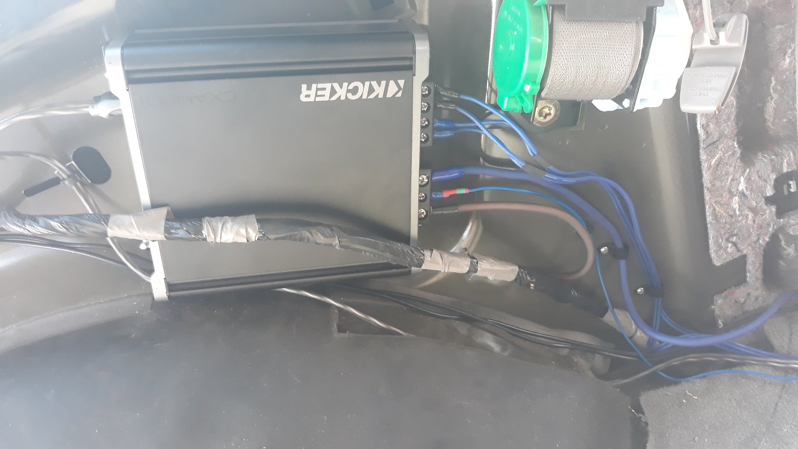

Should work

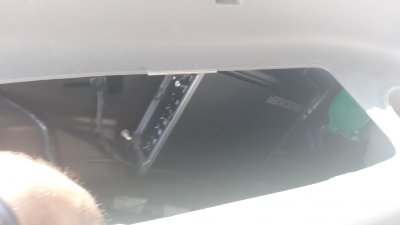

Thats convenient
And thats how i got the bolts in

That's the cubby hole on the back of the Denali XL 04 and I will be able to adjust the amp without removing the entire panel because I mounted it in the 02 Factory location the other one photo is just showing how I got the bolt to poke out of the hole since I couldn't fit my hand back there
