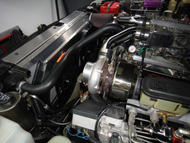

I have the flex-a-lite 280 kit... i love it! it works amazing!
