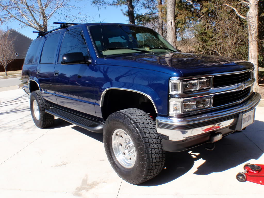

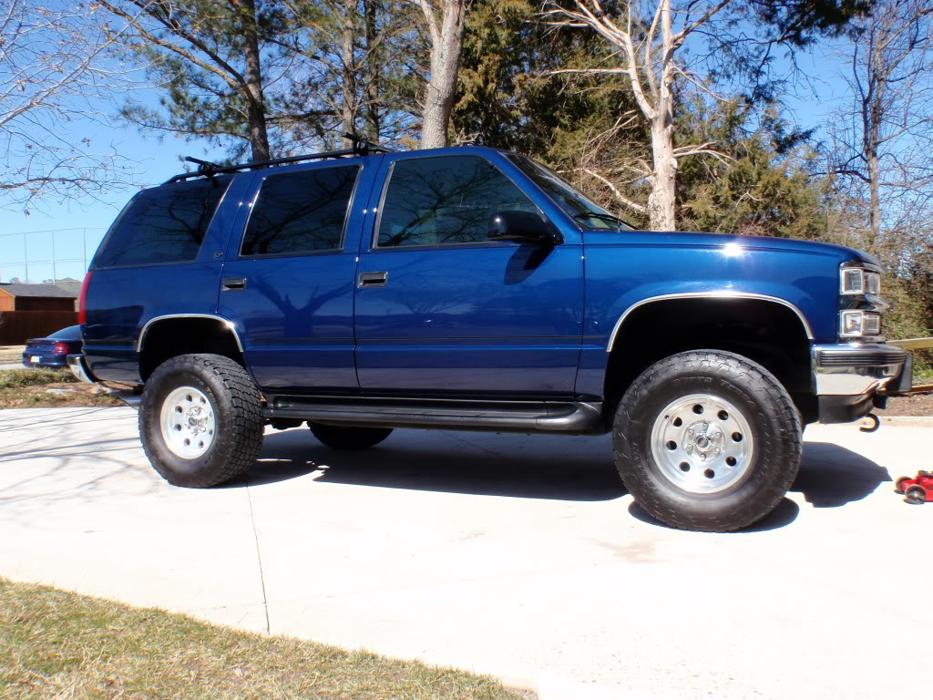

Ok. So I found out Napa had a 3m stripe off wheel (Im assuming its the same as the eraser wheel) and for $40 it was mine. Brought it home and tried it out....It to took a little while but after going back over it with some XMT ultra fine swirl remover and a CCS polishing pad everything came out pretty good....no new paint job for me. Thanks guys for the input!

Well...its not 100% gone. Its just not as noticeable. I didn't realize this till the sun hit it. I've cut the clear coat ,polished and waxed and its still there kinda. You wouldn't know unless you were looking for it...all and all I'm happy though. I will post final pics later...gotta clean my wheels first.haha
