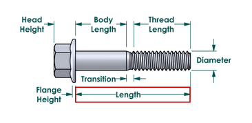

Hex head bolt length is measured from the contact surface to the end, not the the overall length:

Looking at the photos those “look” to be the right length bolts.
I have read where people unknowingly used the long ones that came with some direct drive starters and had to use spacers/washers to make up the gap. You’d know if you had those when trying a gear reduction starter - the threads would bottom out and the bolt head wouldn’t meet the starter.
