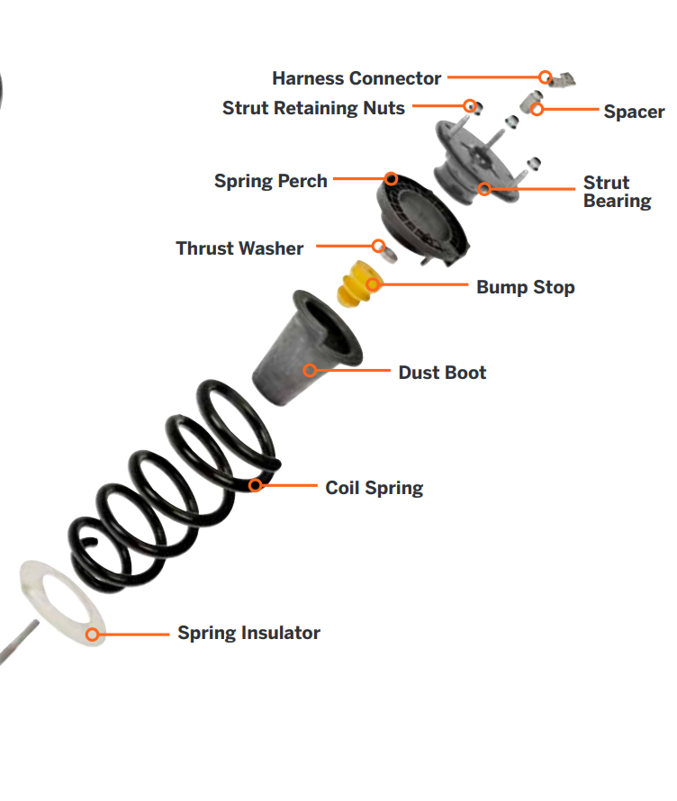

Deleting the z55 will make you want to get rid of truck. GM made z55 replacement struts guaranteed for life. They’re one & done now. Here’s the parts list from R/A to rebuild the front z55 on your Denali. Disregard the TPMS & z95 Magneride (Esky) struts and order z55 / autoride.
